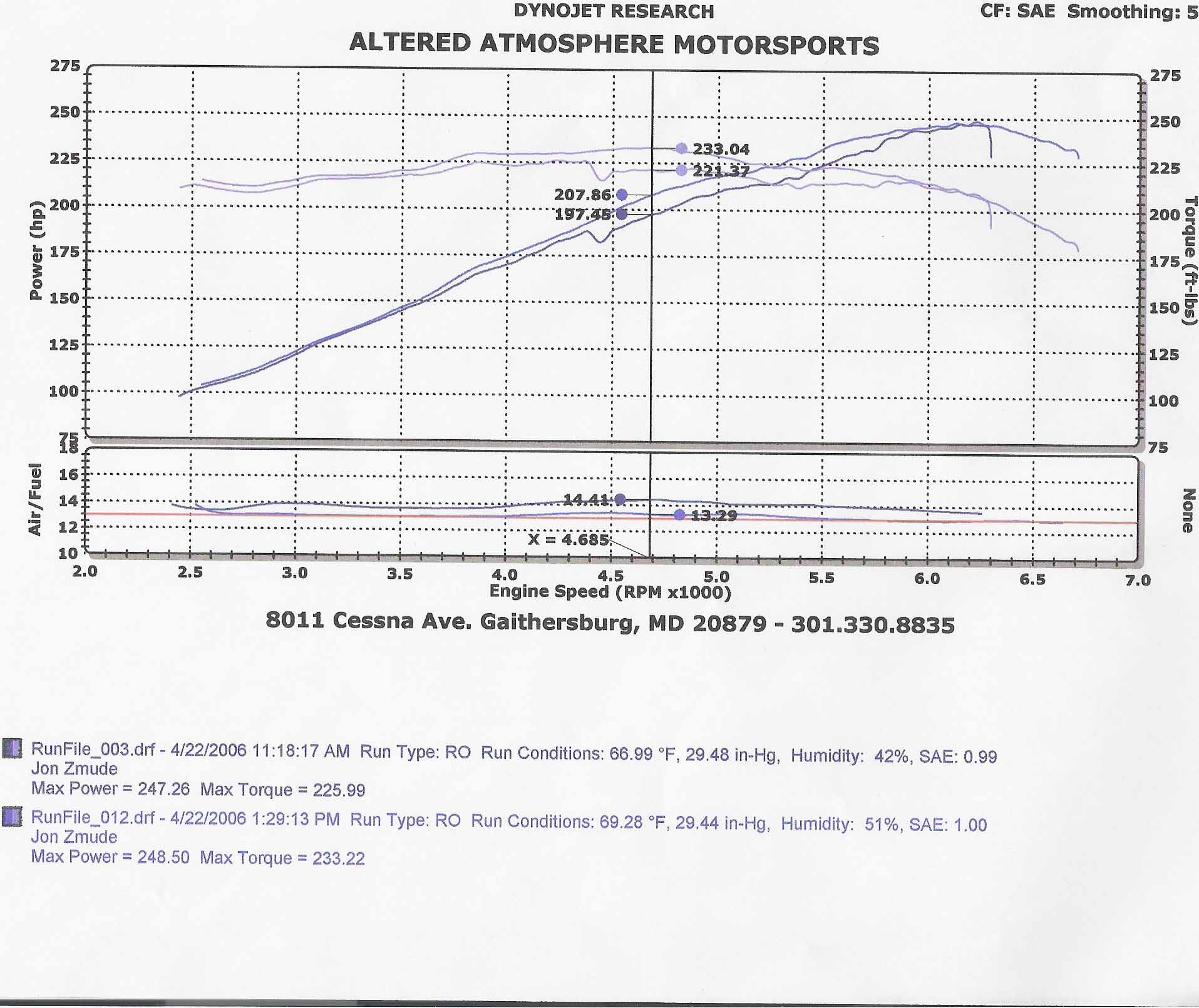

I had it done.
From what I recall, they basically have one map that is used regardless of what mods you have.
I spent the money to have it dyno tuned and after the dyno tuning it wasn't much better then when they just used their base mapping.
For whatever reason, I didn't get much up top. At the time I had a stock airbox and this might have been why. But, I did pick up a lot in the midrange which is probably better anyways. I could definately feel a difference.

Originally Posted by JZ39
I had it done.
I had it done.
Gains of 10HP and 11.5lb/ft torque? That's pretty impressive... taking that into consideration with the increased redline, that just solidified my decision to have the flash done. Thanks.

Originally Posted by Bimmer G
Did you do your's when you were stock and are you recommanding to get the reflash done or not. Like right now i'm running Borla header's, Invidia test pipes, HKS Ti exhaust, AAM plenum spacer, cai, and 2 degree advaned timing.
I would recommend having it flashed. At the time, I had Stillen dual catback, Alphawerks headers, K&N panel filter and Motordyne spacer.
Just pay to get their basic flash done. As I said, they did about 10 runs after the basic flash tweaking this and that and didn't get a whole lot over the basic flash.
The numbers speak for themselves: there is more power over a large part of the RPM range. I wish I had my intake at the time to see if that might of helped me pick up more on the top end.
No change to gas mileage.

Originally Posted by SILVERSURFERG35
Waste!! Waste!!waste!!waste!!waste!!waste!!
How does that dyno constitute a waste to you?
There are not many mods for a G that give you 10+ hp and torque over a broad RPM range as this?????
I agree that there are other alternatives that may even be better. The fact that I lived nearby and could get the dyno done is what sold me.

One other thing:
My car had made more power on a cold day than the baseline dyno I have here. When I got this done it was raining like a b**** and that humidity probably didn't help things much.

JZ39 what was your gains before the flash and after the flash ?
