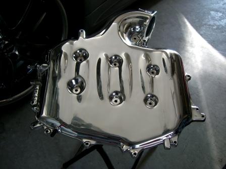

I say, MD 1/2" spacer with one of my polished plenums
