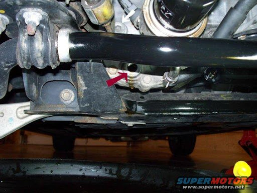

Here's a picture of the front differential (got it from a forum member). You actually missed that when you did the oil change. Is right there behind the oil filter.
Does anyone know the torque setting for tightening the transfer plug and front differential? From Bythabay's video, the rear differential is 25 lb torque.
