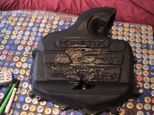

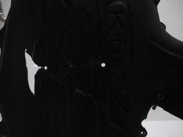

I'm going to set the background first. I drove 4 hours down twisty 2-lane Alabama roads last week to stay at the beach with my family. When I got there, I checked the manifold. It still had a few small cracks in it (the usual), but nothing threatening looking. To be safe, I slathered it with black silicone to keep it together for the drive home. About 3 hours into the drive, coming out of a fairly sharp corner, I hear a loud "POP" from the engine and my car DIES while travelling 80mph. Power steering GONE, power brakes GONE. I try to crank it back but it fails. My car coasts to a stop on the side of a 2-lane highway in the middle of nowehere Alabama. Great, just great. Pop the hood, and here is what I see (pictures included). Well, to make matters worse, my cell phone has zero signal. So, here I am, small white 19yr old preppy boy with a nice broken down car, 95 degrees, in middle of nowhere Alabama... sounds like a prime target for robbery/theft. Well, I decide to PUSH my car until I find a small town. Luckily I got to Forkland, AL within a mile or two. Long story short, after trying to patch the hole with rubber cement patches, aluminum cut from soda cans, etc etc, I decide to just get a tow back to Alabama. I call for the tow truck and get charged $150 to get towed back to Tuscaloosa, where I change back to my stock manifold and everything runs fine. I tried calling Kinetix when it happened (Saturday afternoon- left a voicemail), and also this morning with no response.
I am furious to say the least. I do not want a v4 plenum. Even though it may have solved all the problems, I have a bad taste in my mouth from Kinetix now and do not wish to put their brand name under my hood. I believe I am entitled to a full $399 refund IN ADDITION TO Kinetix paying my $150 towing fee. Does anyone feel this is out of line? All I can think about is how grateful I am that my power steering and power brakes didnt go out in the middle of that 80mph turn... I might be dead right now. Then Kinetix might have a wrongful death suit on their hands... not to mention all the plastic composite powder that surely got sucked into my engine when the manfiold blew apart. Sorry for the long post, had to say it all somewhere. Hopefully now that this is in the open Kinetix will respond and do the right thing.

Yes, Kinetix has had a cracking problem that they're fixing with the v4 (now being shipped). I think that you were taking a super big risk by driving the car with a plenum that you knew was already cracked.

We should point out the particular plenum that suffered the massive break down was an obsolete v2. This is not to say the new v4 is bulletproof ... only time will tell. I still got a few more open track events planned for the year, so I'll be the first to tell if my v4 explodes If this one holds up well till the year end, then we may be on to something good here.
In addition, a torque wrench is a must folks! You just can't go by feel ... 80 inch-lbs. (~7.5 ft-lbs) is easily interpreted as 'loose' by average Joe standard. With a standard 1/2" rachet, one could easily generate over 120 inch-lbs. of torque!
Also, looks like it might be wiser to leave the crack alone if you do find a leak in the future. If a patch is attempted, it will restore the pressure differential and consequently increased load on the plenum. A bad combination when stress fractures already exists and could easily get out of hand if enough force is acting on it. Reverting back to the OEM piece ASAP would be prudent.
