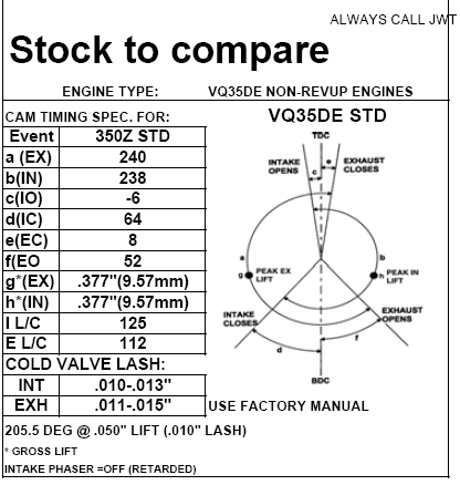

Found the 350z specs
http://www.jimwolftechnology.com/wol...INCL_REVUP.pdf
just not the G35

2003-2004 G35 and 350Z engines are all the same. No difference.
Different power outputs are due to INTAKE, drivetrain losses, and tuning. You can get a NISMO Z that has different cams though...
