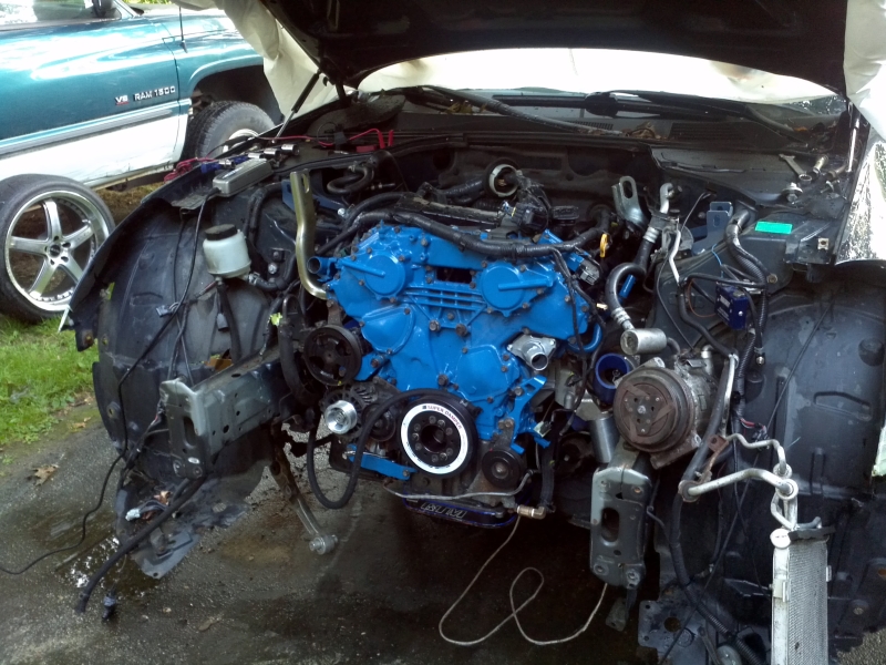

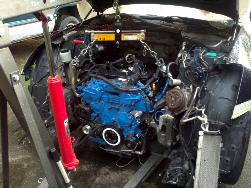

The ac and everything can just be moved off to the drivers side
I see. I also see the harbor freight equipment was used like I'm going to be using. But where did you get the mounting brackets from? Although I only see one.

From: Massachusetts
I do have both of the brackets and I actually got them from work (Infiniti dealership) I took the motor out without them, but OMG was it easier with them.
