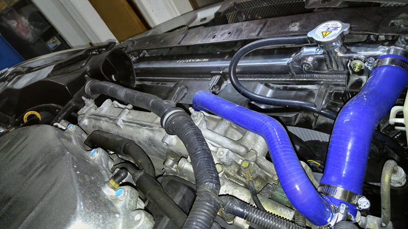

Pics of the Koyo V2588
Figured I'd bump this as this thread as it helped me pick out a replacement radiator after my stock one cracked due to wear and tear.
I choose the Koyo V2588 as Deepdiver pointed. (I am 6MT, this radiator is for manual transmission)
Install was fairly simple. I even swapped out my mishimoto radiator hoses with blue Z1 hoses while I was taking everything apart.
Thing to keep in mind with the Koyo V2588 is that it is thicker than stock oem radiator, so it will render being unable to put that plastic air diversion piece that is used with the intake to direct air towards the box/intake. You can see that I don't have it with my Stillen intake, because the radiator pushes it back to be able to mount them with the plastic rivets compared to stock radiator.
I was impressed with the construction and and happy with the new radiator thus far.
