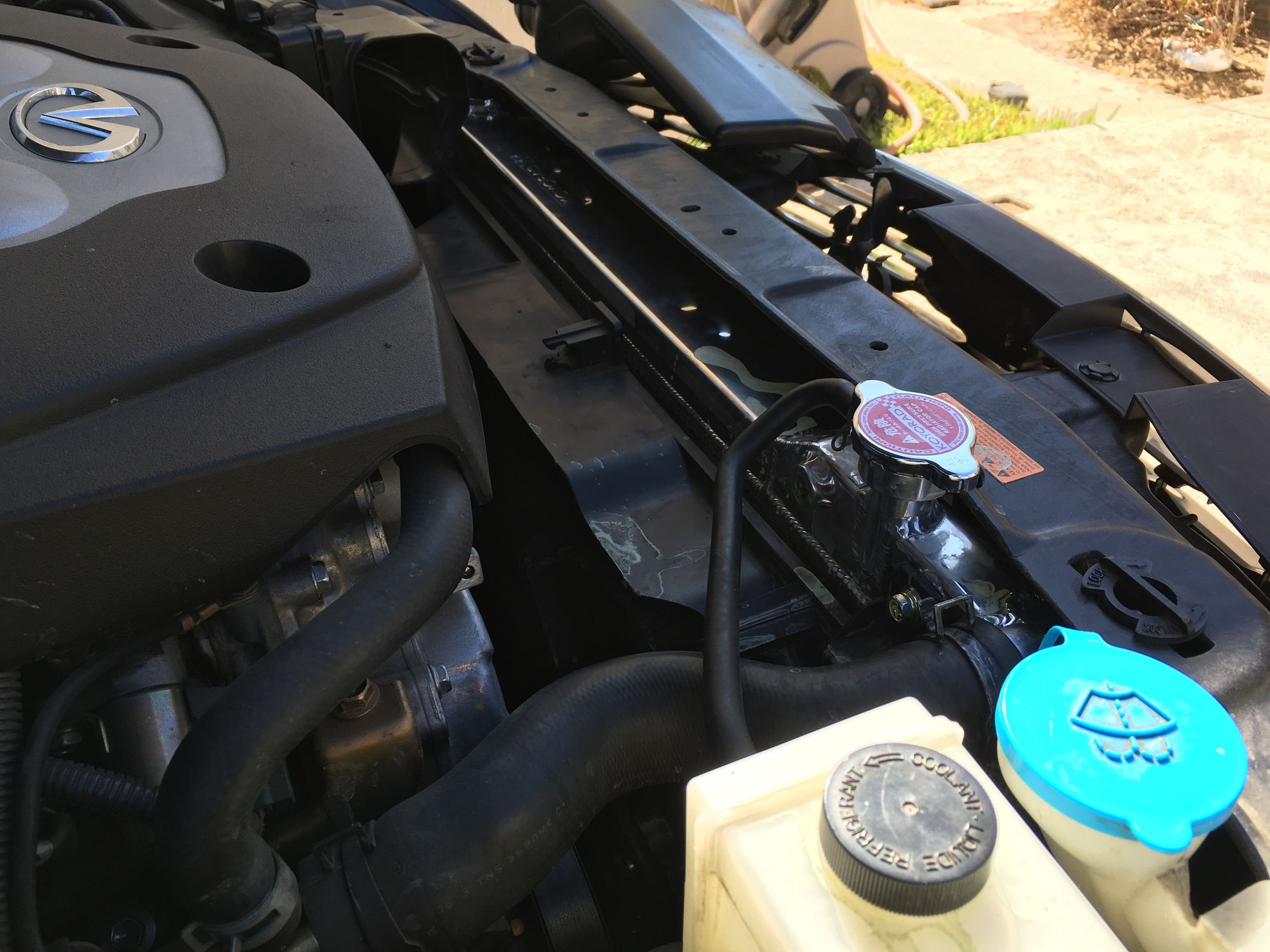

Sorry for the late response. I finally got a chance to take some snapshots.
Here is a snapshot of the fitment from the passenger side. This is with the intake air scoop removed.
Another snapshot of the fitment from the driver side.
Top-down view of the radiator, with stock radiator fans mounted. It mounts perfectly.
This is with the intake scoop installed, it does not align perfectly. The radiator+the stock fan pushes back against the intake assembly so your have a few millimeter displaced. I just used a zip tie to secure the intake scoop. No biggy.
Top-down view, shows that the stock fans can still be used - no clearance issues.
This was the only modification I had to make. For whatever reason, the neck of the radiator didn't protrude enough in toward the back of the car. We had to shave a part of the fiberglass shown here to get it to fit.

I have seen mishimoto fitment issues on posts back in 2012. I thought thy might be fixed. I purchased one this week and was not please at all with the fitment at all:
-Condenser tabs off slightly, had to slightly bend inward to fit
-posts for rubber mounts were angled away from holes. Had to remove and slightly knock inward.
-Too much weld on mounting posts did not allow full insertion of rubber mount
-Front tabs insertion points for fan assembly were not wide enough. Had to trim the tabs to allow them to fit.
-Slight imperfections pushed rad out enough that it does not allow air box to fit back in. Had to remove everything and trim more stuff.
-Had to trim away at frame top to allow filler to fit in and be able to turn cap effectively.
