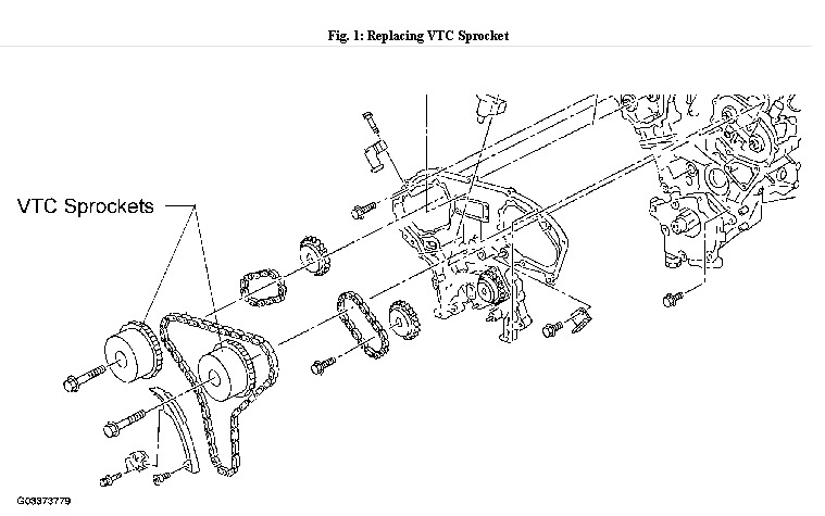

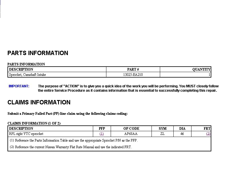

Multiple issues which could be the common timing chain tensioner or the VTC sprockets. It has to do with oil needing to get up to pressure during start up on the timing chain tensioner. Depending on the type of oil filter you use and how long the car sits for is if you have the noise. This issues has been going on for a long time on the VQ platform and if you really want to spend money then you can overhaul your timing components like guides, tensioners, chains and sprockets. More thank likely this is the component you need to change.

Also I am no master technician but just a regular joe schmoe but I do believe our vehicles do not have adjustable lifters but instead have shims that are used to bring that back in spec. Then again I would recommend you do some research and maybe hit up a qualified master infiniti technician.
