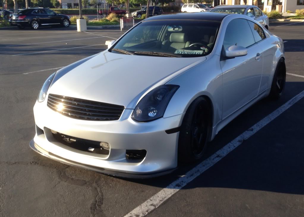

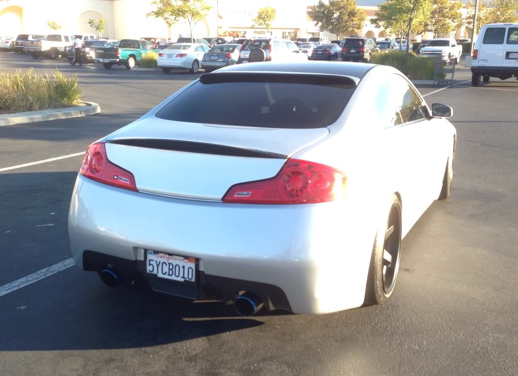

But here are a couple pics of my lovely G *iphone pics lol
