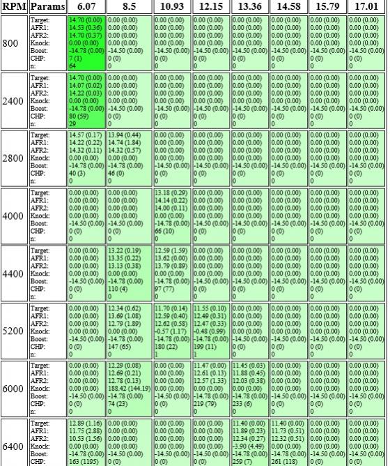

Here are some fuel tables ran through a program created from a guy over at my350 with some logs I supplied him.
Looking at live data, o2 sensor voltage is correct in regards to my research. Like I said it most likely is a exhaust leak that I will have to hunt down when I get the time.
