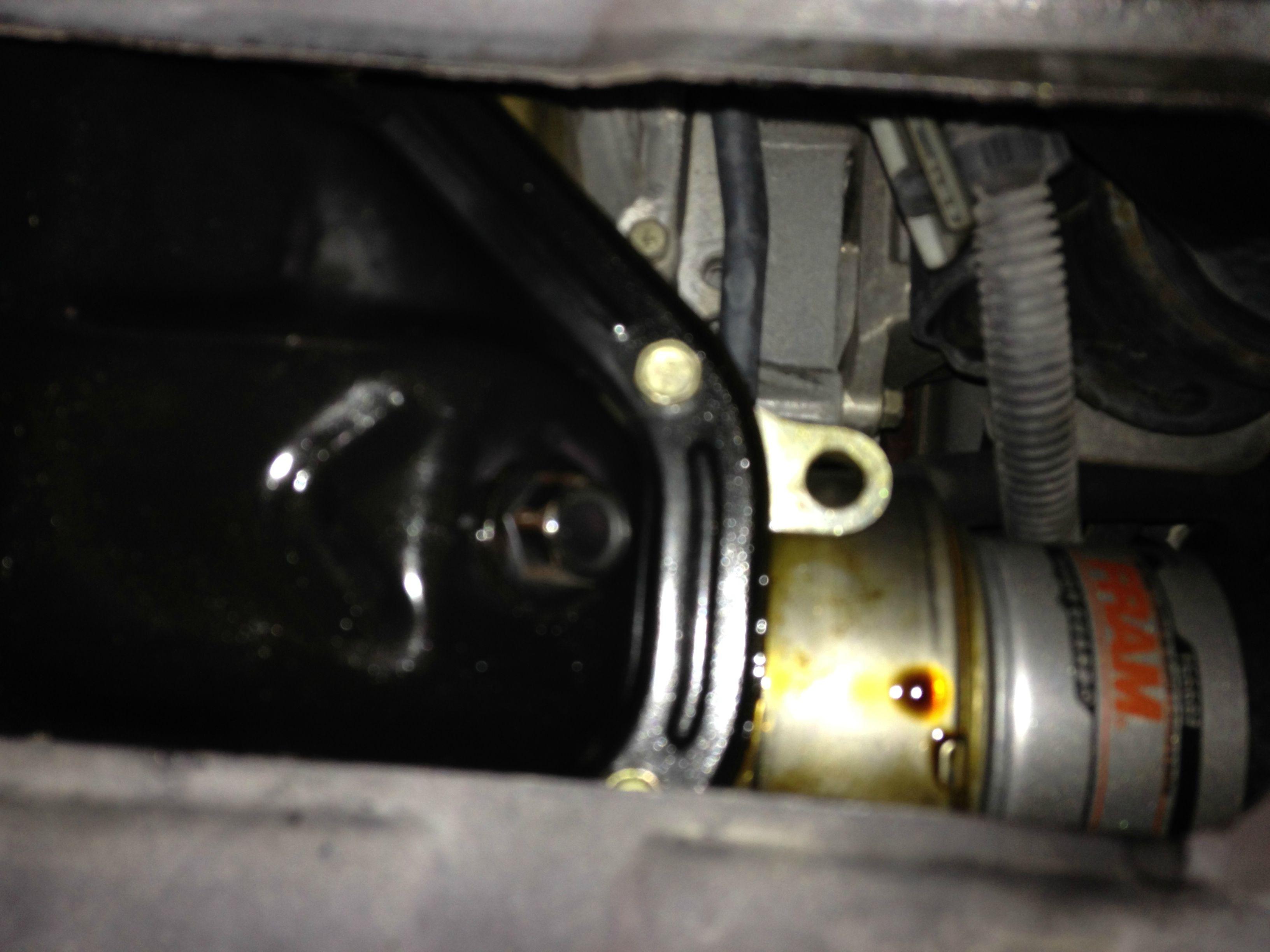

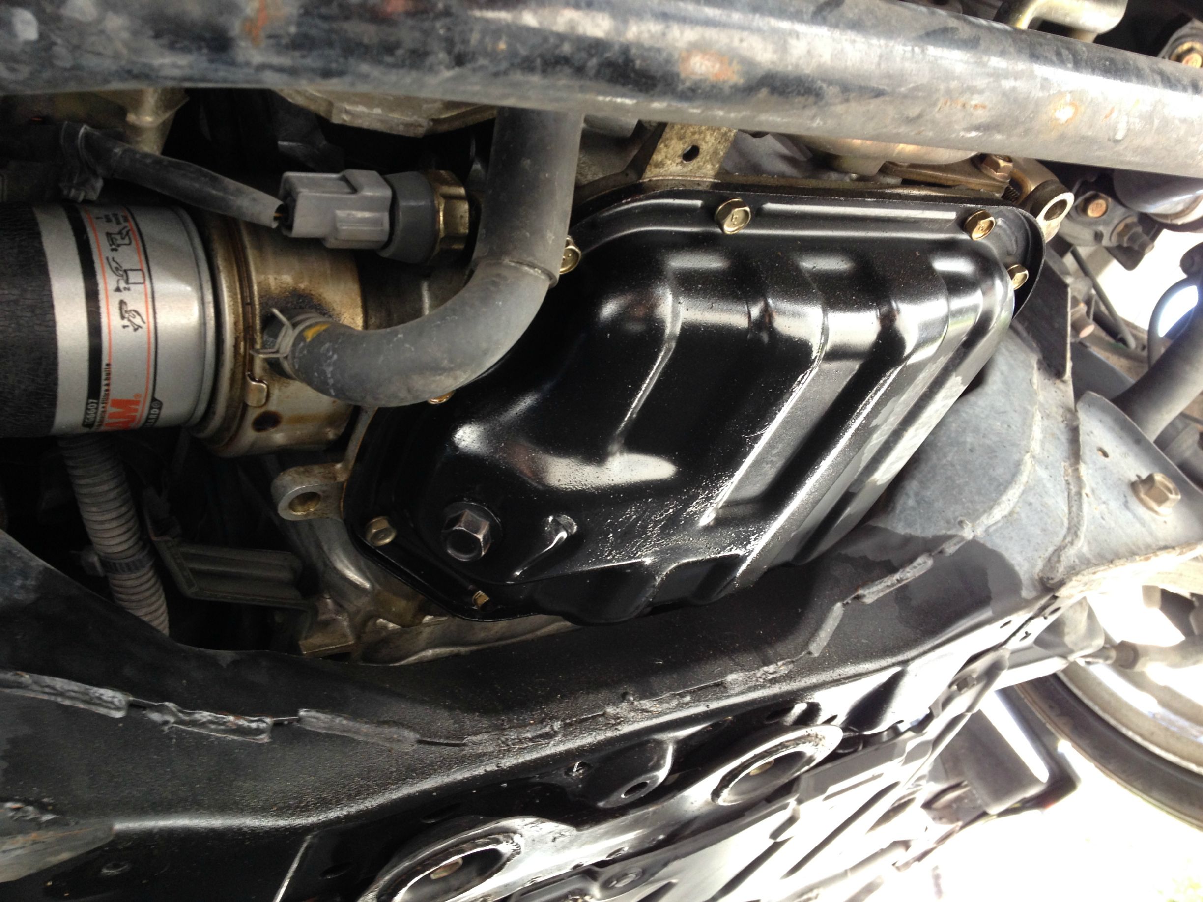

Just bought my coupe at 77k miles, it now has 78k. I noticed a leak today and went under to investigate. There is oil all over the oil pan. I checked to see if the oil filter was on tight and it was. I tried to trace the wetness up as far as I could see oil and I don't think it goes above the oil pan. Could that mean that I need a new oil pan gasket?
Attached are some pics I tried to take of the oil on the pan.

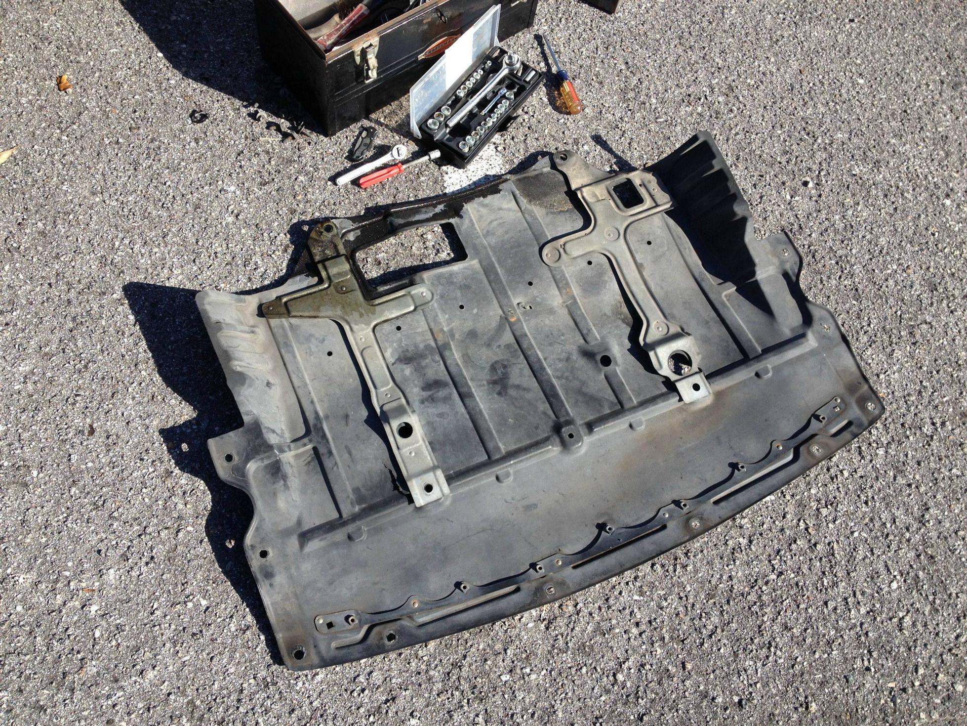

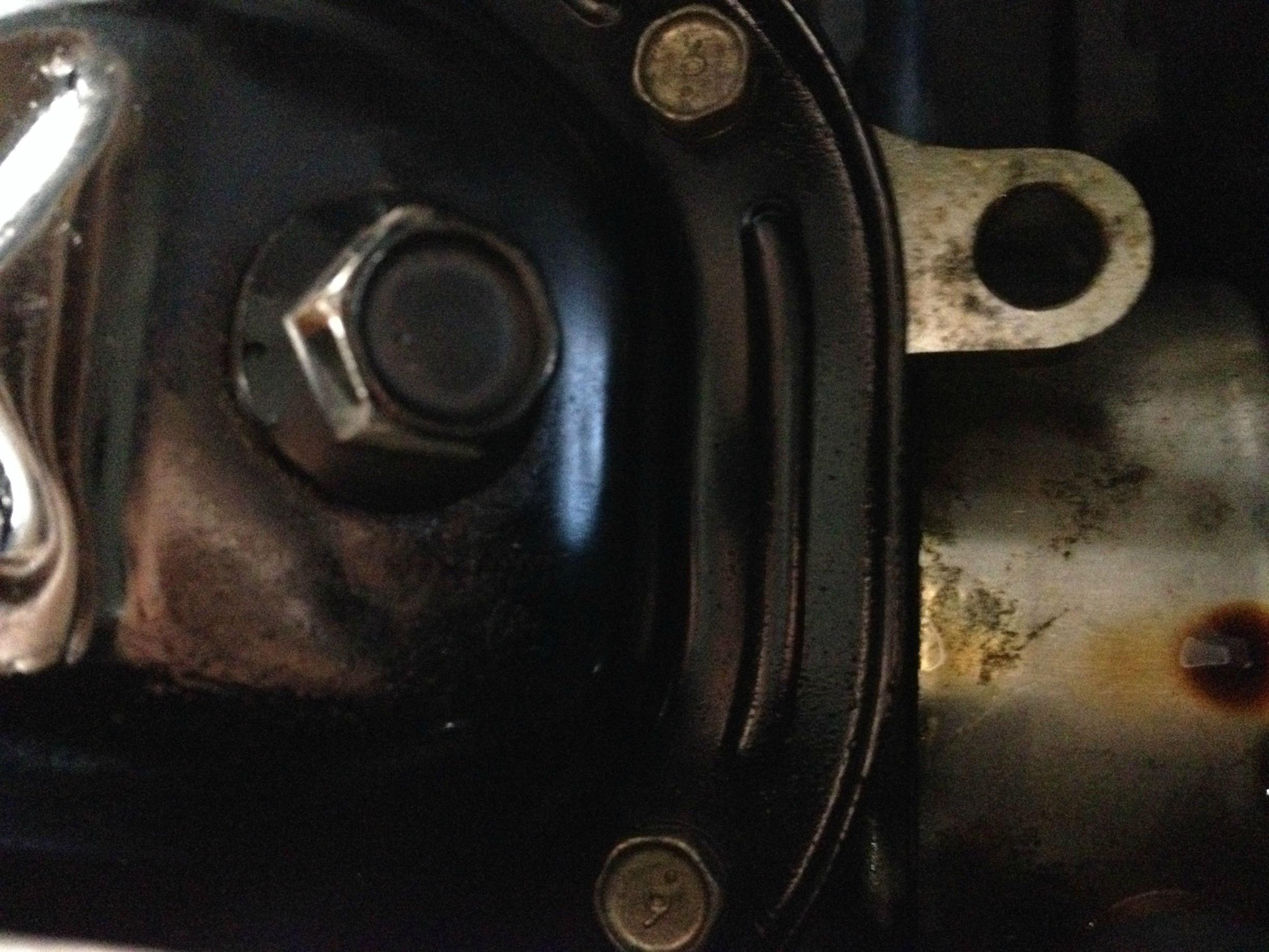

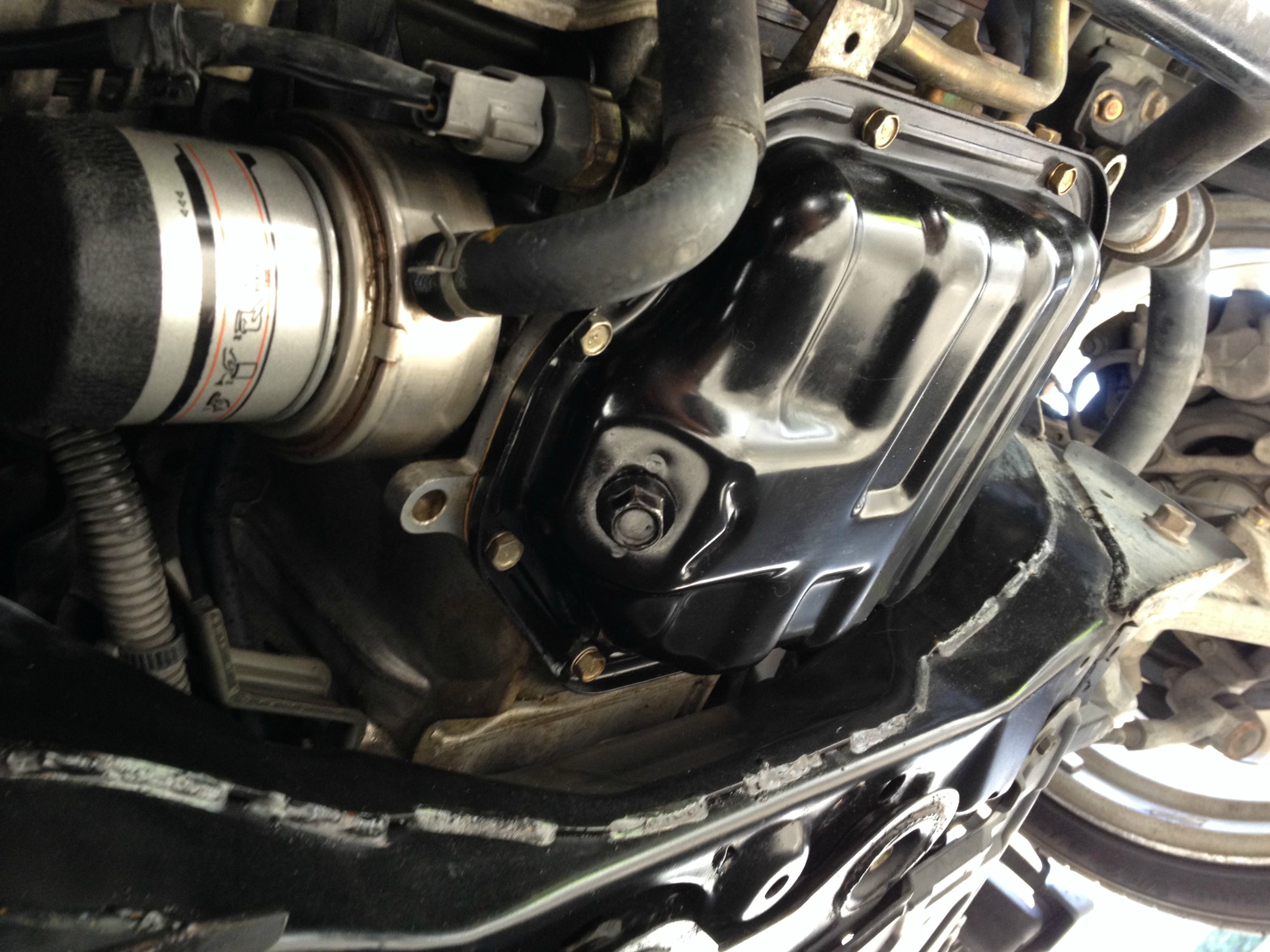

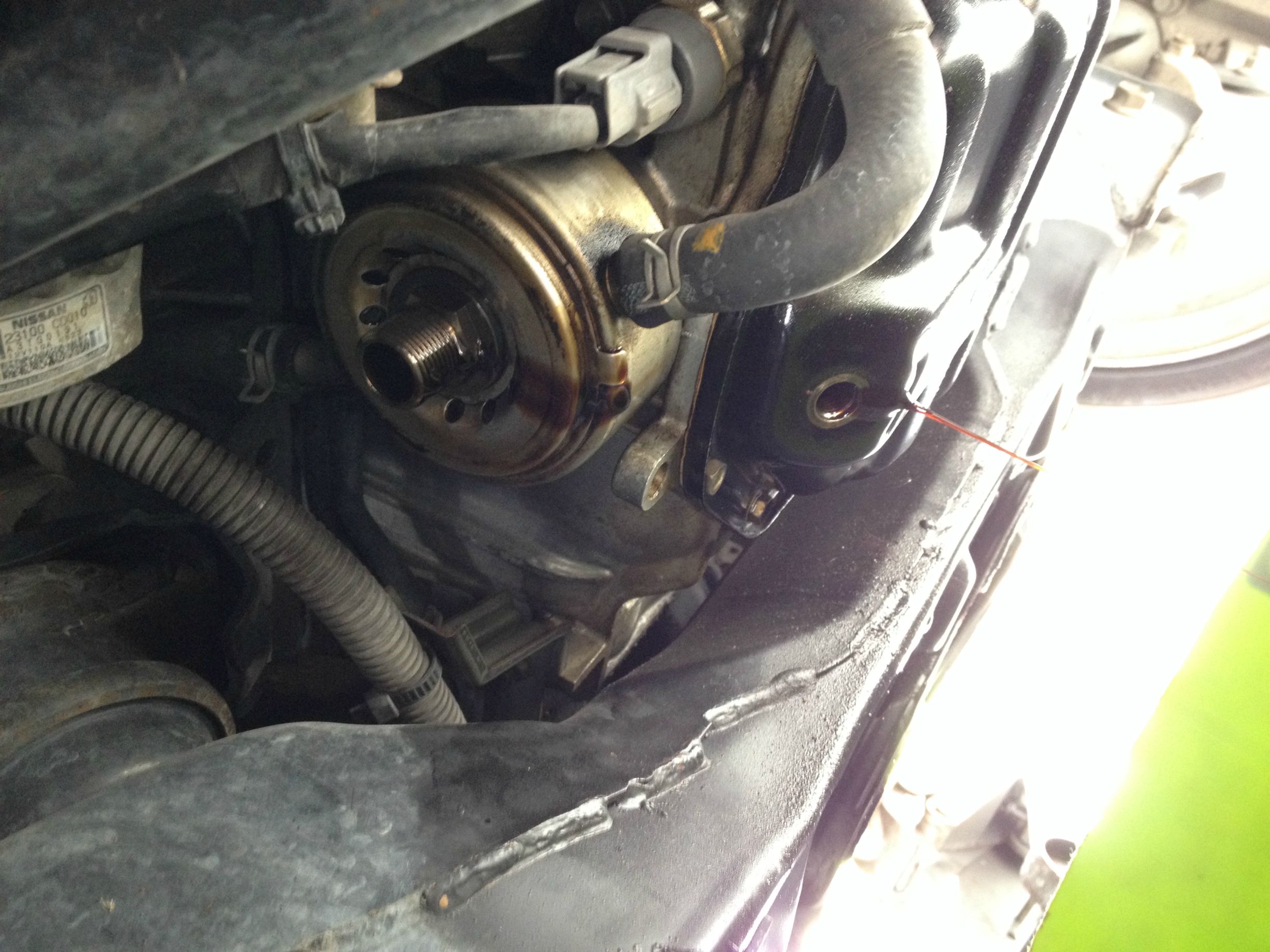

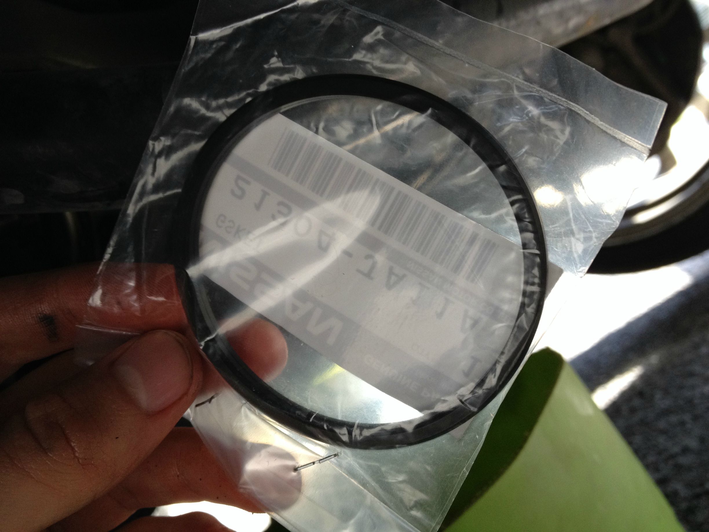

Just finished replacing the oil cooler o-ring. Here are my results for anyone that has the same issue:
1) Bought the Oil Cooler O-Ring (part #21304 JA11A) from my local Nissan dealer for $6.19.
2) Took off my skid plate with its million bolts.
3) Ewwwww
4) Oil Cooler Stud removal with 22mm deep socket and oil removal:
5) Cleaned up and finished! Let her run then took her for a spin and no immediate signs of a leak!
HUGE thanks to infinitidude and rsingerG35! Simple fix and a money saver.
