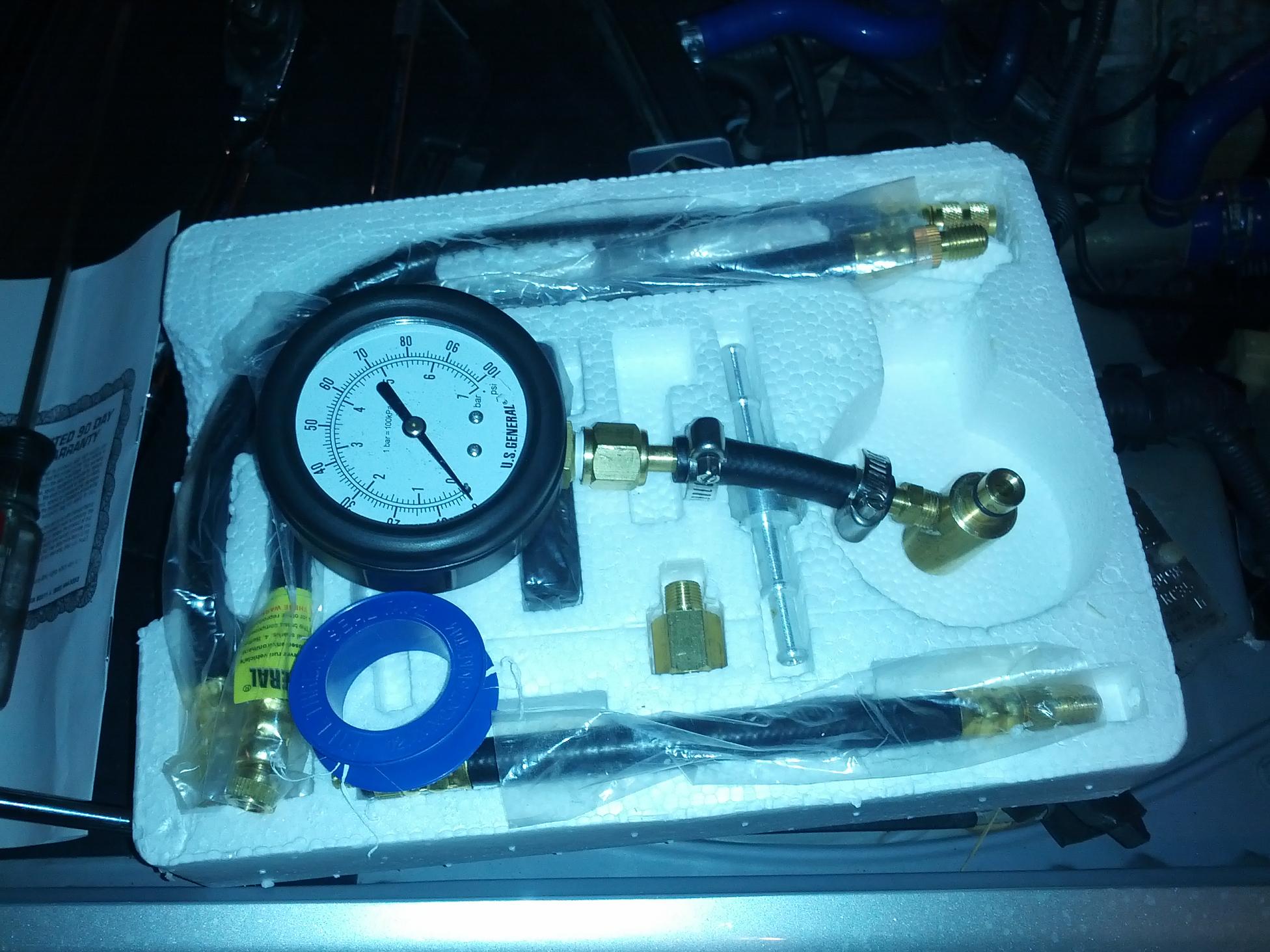

Fuel Pressure
*You will need a new O-Ring for the damper or buy a new damper. I have a new damper on the way; I plan on returning though. I found an O-Ring that will fit perfectly.
I bought the green O-Ring set from Harbor Freight for 10 bucks. The size of the O-Ring I used was: P007 1/4" x 27/64" x "5/64"
You can release the fuel pressure by pulling the 15A fuse in the IPDM and then crank the engine. I didn't bother to it doesn't spill that much fuel out.
I ordered this adapter:
http://www.autotoolworld.com/S-G-Too..._p_166673.html
I could not find a quick connect that would work with though, so here is how I modified it:
1. Remove the schrader valve.
2. Attach the small hose from the Harbor Fuel pressure kit to it and secure it with hose clamp to the end of the fuel rail adapter.
3. Attach other end of small hose to fuel pressure fitting and screw that onto the fuel pressure gauge.
I had a tiny bit of leakage, but it read the fuel pressure perfect and it should be at 51PSI.
*Might want to measure the distance between the adapter and flange. My damper flange sligtly bent when I secured it with the bolts and you probably want to put a small metal tube or something so that doesn't happen.
