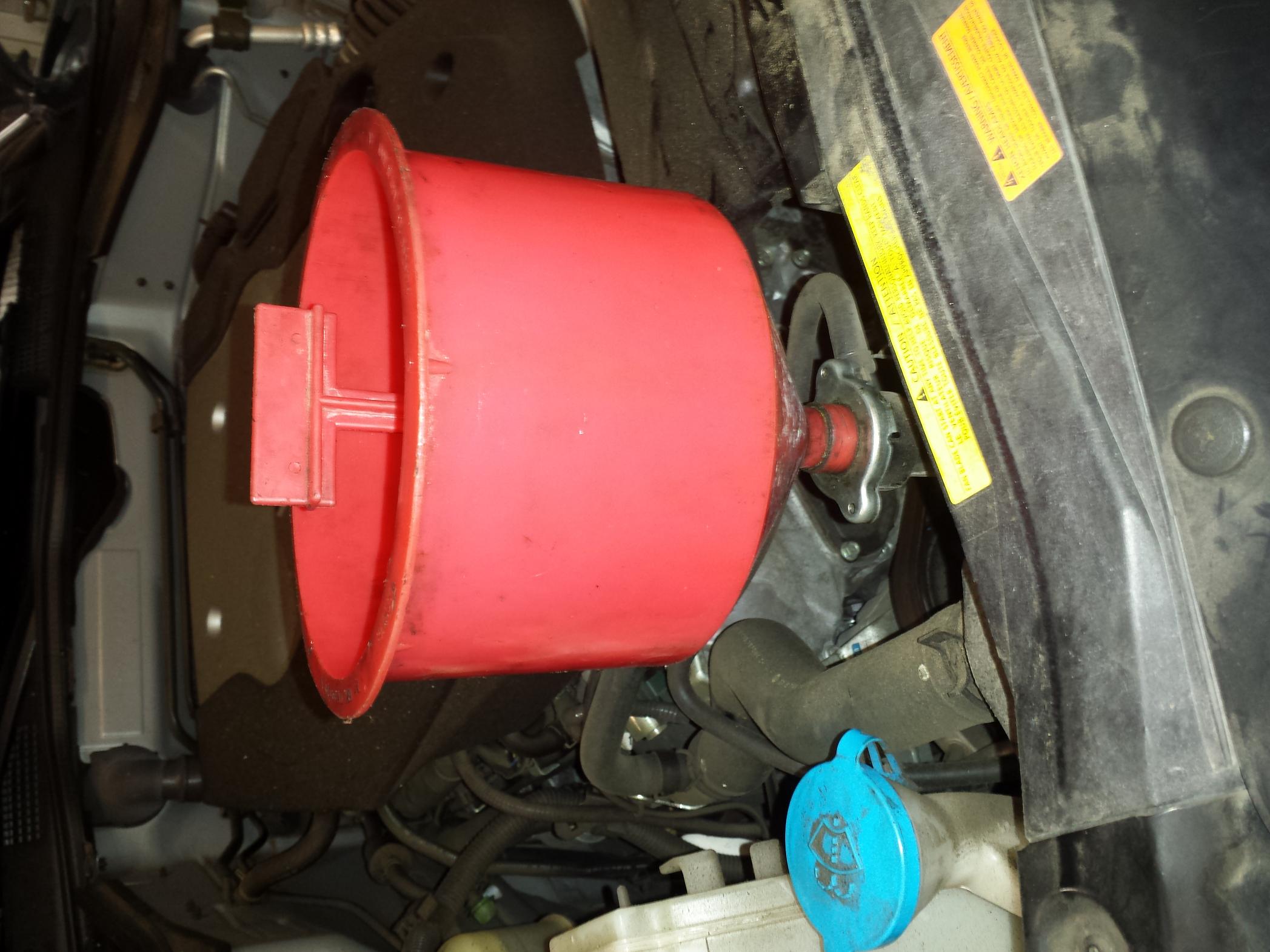

Air can be very difficult to bleed from this system. If it it properly bled out and air returns then you have a leak in your system - Something isn't sealing (water pump, Tstat, head gasket). Many people have had shops not bleed air out properly but I'm sure the dealership would do it correctly. I use a lisle spill free funnel - works very well and much faster than just using the burp valve at the rear of the engine compartment.

Oh how I pitty the unknowledgable techs in this world.
I have seen this time and time again Aftermarket shops do not bleed the system correctly they don't check your fan assembly they throw parts at it and they never fix it right the first time. This is what you need to do.. go get a funnel that attaches to where the radiator cap goes pour your 50/50 mix of choice about half way turn car on with a/c off and heat on 90. Let the car start to warm up. You will see bubbles come up, hold at 2k for about 30 seconds or until the coolant level rises in funnel, turn car of and plug funnel, let sit about 30 seconds then while car is still off pull the plug you should see coolant level drop and burp itself then open the bleed screw enough to see air bubbles coming out as soon as there's No more air from bleeder close it up and repeat the steps until you have heat at idle.
If you continue to have the funnel overflow after repeated attempts to bleed and it mainly does it when you holding higher revs then maybe your head gaskets are shot.but i doubt it. I've only seen a handful of blown headgaskets due to overheating 1 time on the vq35's. Most of the time it's just air. Hope this helps
Attached Thumbnails 2003 overheating.  Thermostat, then water pump now tensioner??-1395745544964.jpg

Originally Posted by infMSTRtech
I hope this helps
It does. All this advice does. Thank you.
I will see what the infiniti dealer says today and go from there. They are bleeding it and hopefully they know how to do it. But this is great info for me and I may need to try it.
