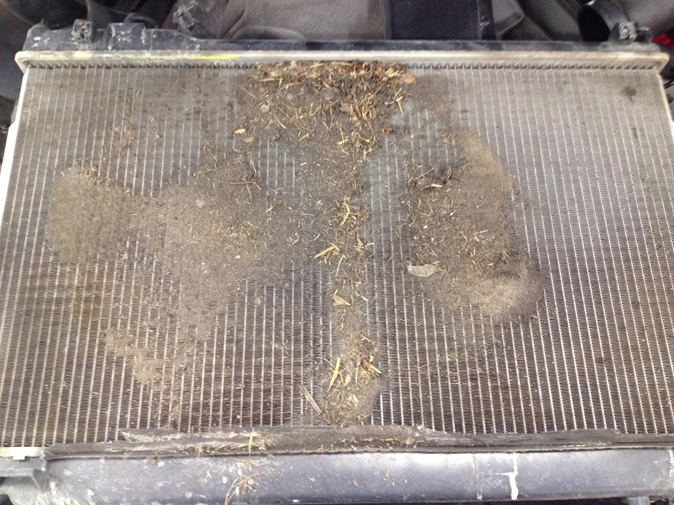

So I got a call from the dealership who is looking at it.
They say the RADIATOR IS DIRTY and it is 70% covered leaving not enough surface area to transfer heat. Additionally, the import shop put straight coolant in it not the recommended mix with water. And the tab on the fan shroud is broken.
Wow.
Wow.

FYI, here is a picture of the dirty radiator before they cleaned it.

I drove 50-75 miles and son of a gun, the car overheated again. AGAIN!! Same exact thing. Started blowing cool air at idle but warm while driving. Then a few minutes later, overheating and coolant coming out the overflow.
So the dealer was sure, SURE this was the problem. But still no luck.
One month. I have had the car for about 4 days of it. And it is still doing the EXACT same thing.
What the hell?
