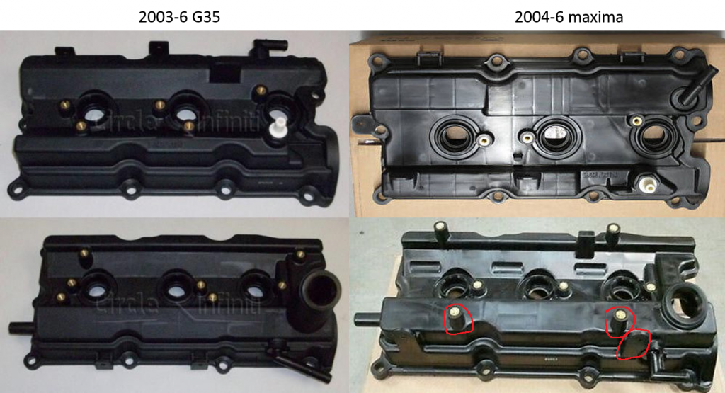

Valve cover gasket/covers difference if any other than the cost?
After further looking seems that I have found my answer that they are the same just a few mods have to be done to make it work.
https://g35driver.com/forums/faq-diy...lug-tubes.html
Part numbers: 04/05 Nissan Maxima v6 (valve cover)
*13264-7y000
*13264-7y010
http://www.nissanpartszone.com/parts...264-7y000.html
gaskets:
13270-ea20a
13270-ea21a
03-07 G35 valve cover
*13264-am600
*13264-am610
gaskets:
13270-8j102
13270-8j112

I have been wanting to know if the passenger side is a direct swap can anyone pleas confirm or provide a link please
Old Nov 11, 2014 | 06:49 PM
RonBuff's Avatar
Joined: Oct 2014
Posts: 12
From: Buffalo Grove, IL
Should direct swap on passenger side.

The two compared directly in picture.
Cut three red citcle parts, just small modification. Better than R&D hole saw things with old valve cover. They ask $11 for one seal??? You need six.
Great thanks to turnerMax.
