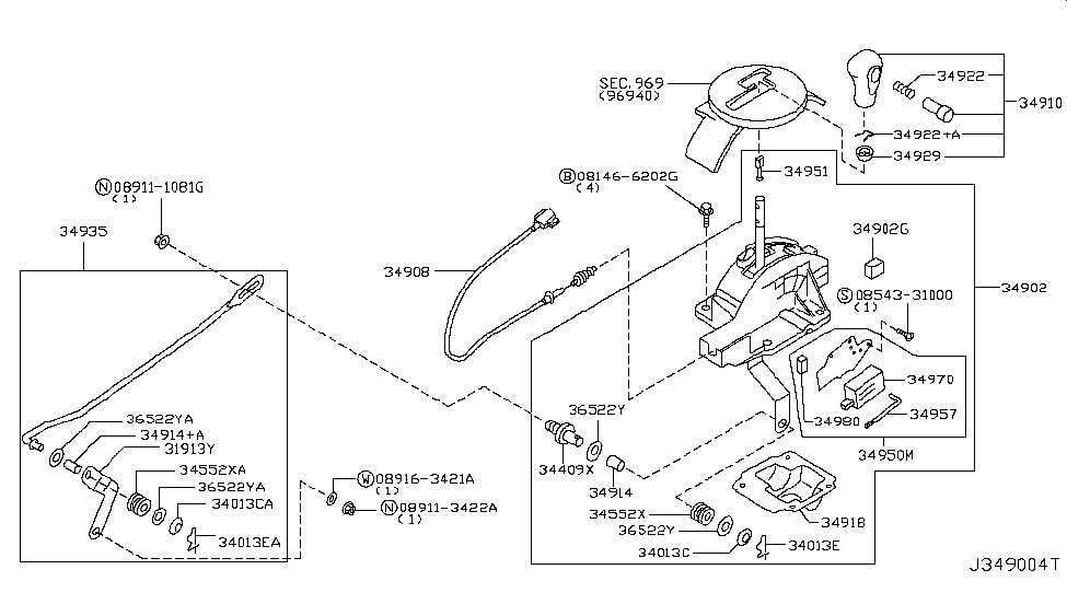

would it be the one here or is there another switch on the actual transmission ?

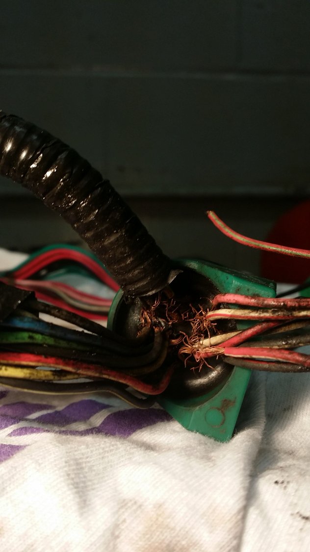

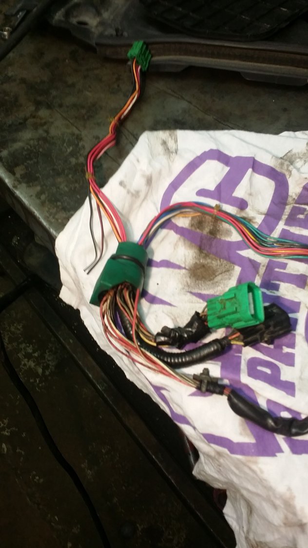

So after a bit of a battle figuring this out it turns out it was a wiring problem .
This is the harness going into the transmission and all the wires are stripped and touching on the one side of the green plug and 2 wires are pulled out . Now to try to find a new harness and I think my problem should be solved .
This is just a heads up if you are having a similar issue to check this grommet thing . Btw it's a bitch to pull out
