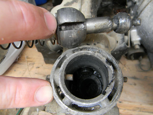

This is the only thing I could find that's even remotely close to whats going on. In this pic there is a pin in the housing and a groove on the shifter literally there just to keep it from spinning. This is not a Nissan shifter tho. Found a Toyota site with a similar "pin" conversation tho. Guess I'm taking it apart today..
VQ35 shifter is not like that. Just order a replacement shaft and swap it out.

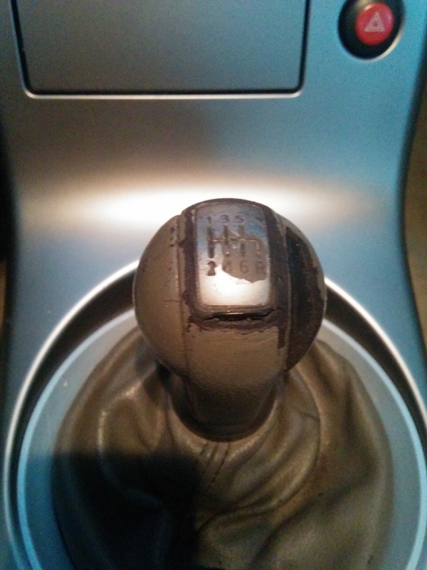

ScraggleRock's Avatar
Joined: Dec 2013
Posts: 6,811
Likes: 738
Before (don't know how the hell this happened. Jersey thinks it was previous owners right hand ring collection. Seems legit)

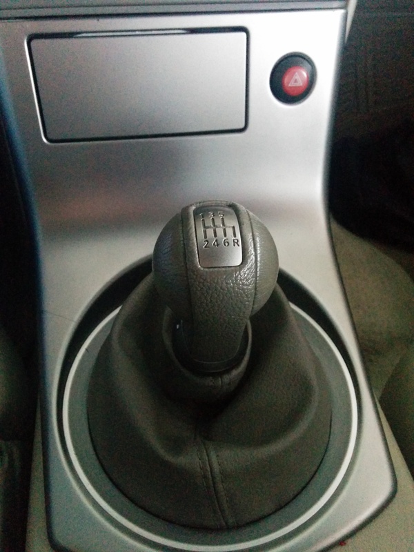

After (new boot too; thanks itpro2002..wherever you are.) Haha
