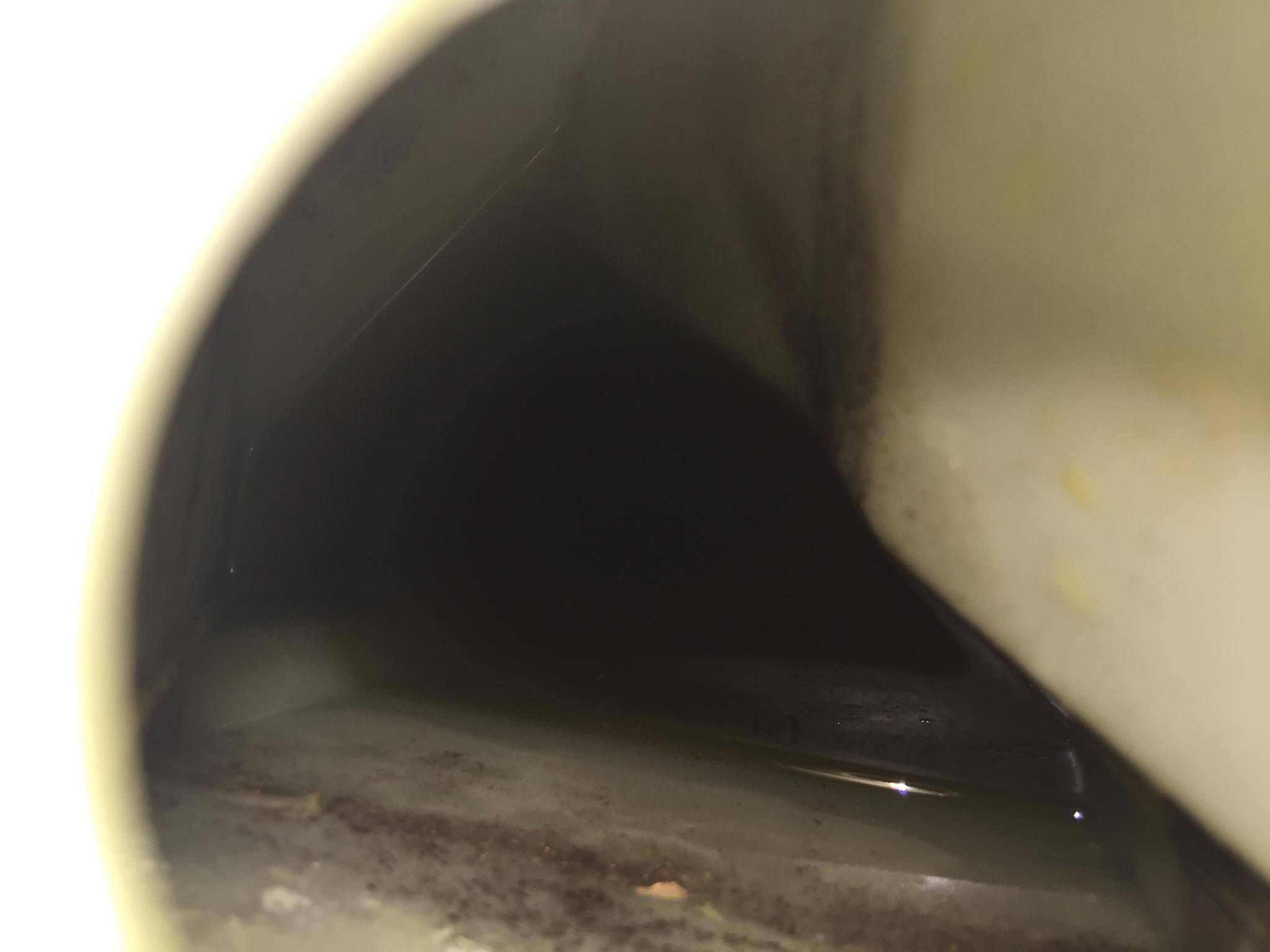

Nothing really indicated blown head gasket. Oil is completely fine, no white smoke, no loos in coolant. And I jut opened the coolant reservoir and puled out some with a straw, its fainting green. In the radiator cap there is some rusty looking build up and the fluid has some particles in it

You can have a blown head gasket and not have water in the oil! You can also have oil in the radiator which is what that brown/green crud looks like on the opening and cap. Compression test will prove my vast knowledge is correct and it is what the dealership recommended...Gary
