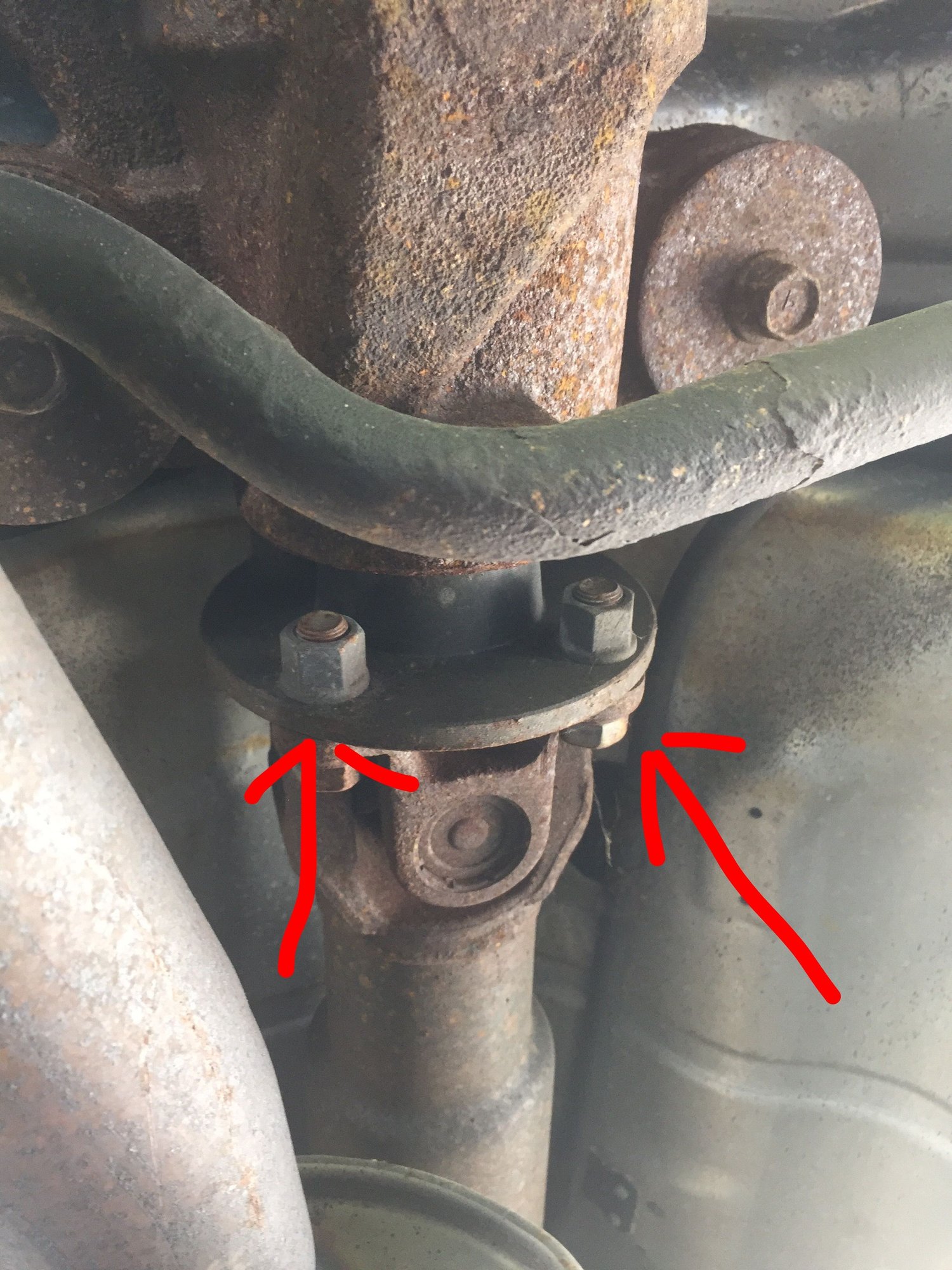

Above is the drive shaft where it connects to the diff. Remove the 17mm bolts the red arrows point to. This is actually where I am currently because I just moved and all my tools are in storage and for some unknown reason, I forgot to get my 17mm wrench! But anyways I'll post the rest tonight. Basically once you get that off, the only thing holding the diff on is the 17mm bolt on the back (next pic) and the 2 17mm bolts on the front/sides.
