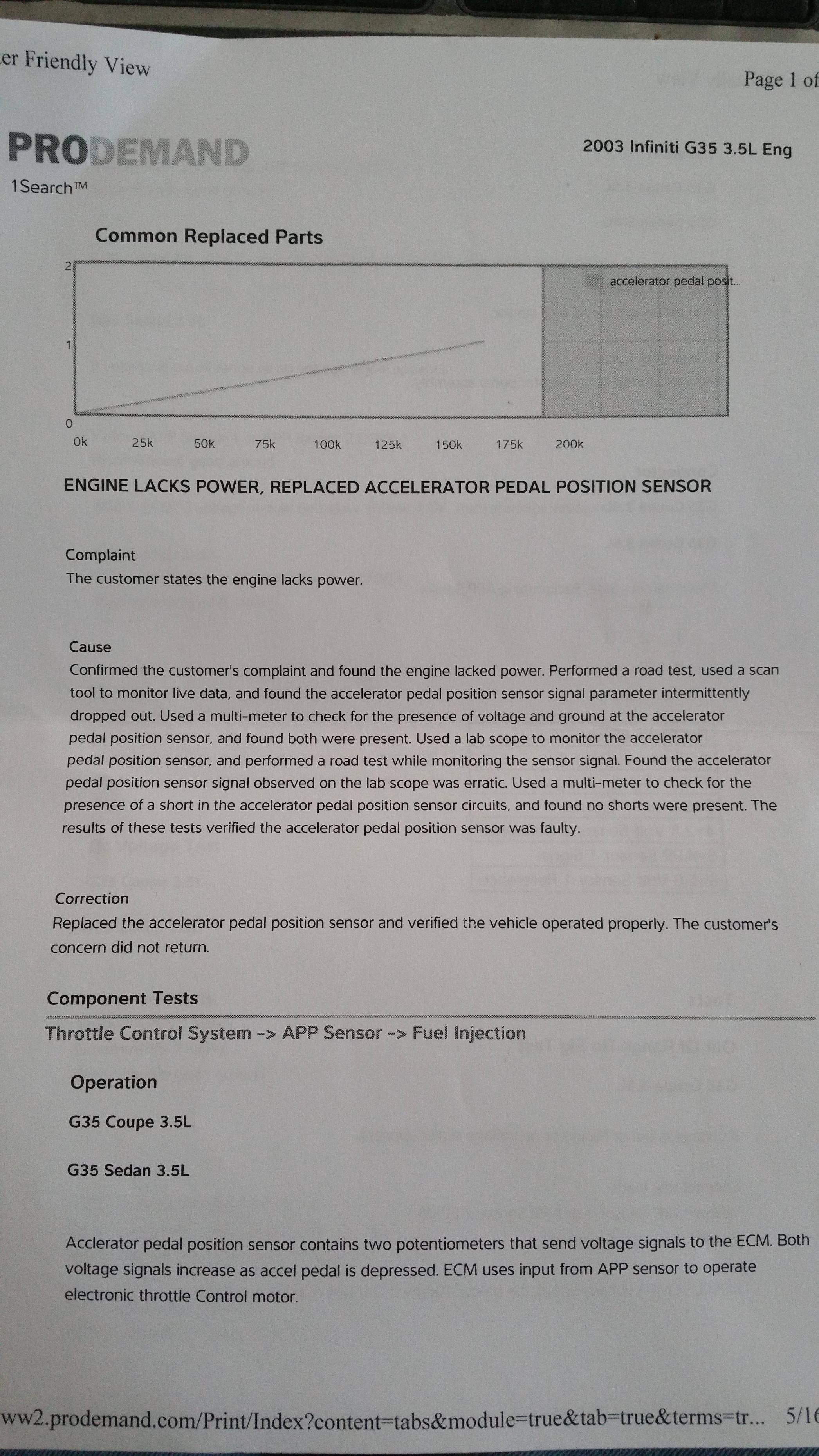

So I think we pretty much nailed it down today at the shop. We hooked up the Modis scanner upto the car as it is able to directly read all the data from sensors ect. Parked and warm we tested everything and all looks good. No codes on any of the computer systems and all sensors have the correct data.
We take the car for a spin and low and behold it starts acting up. So on the graphs for accelerator control everything is out of wack. We tried it again for ***** and when it acted up we pushed the accelerator pedal to the right with our feet and low and behold the data corrected and the car took off like it normally would.
SO I got on the prodemand and looked up some data for the accelerator pedal position sensor and found a interesting notation about past fixes. I will post the printout below. But essentially this issue normally pops codes but I found this instance in the computer about where it was not throwing a code.
Im going to pull the pedal assembly out of my parts car and install it in the coupe and see if the problem is rectified.
EDIT 1 - Assembly replaced on 5/16/16 with all reset procedured completed. Will report back findings on next drive.
I think you may have actually solved it......
Because I forgot to mention I had codes for throttle pedal something something I think it was P0123 and P0223 but I thought the fault had nothing to do with the pedal.
