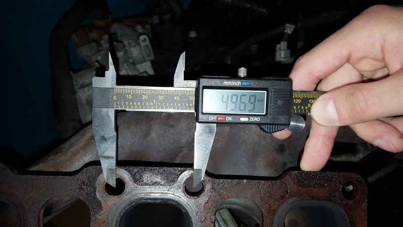

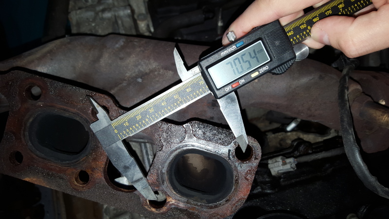

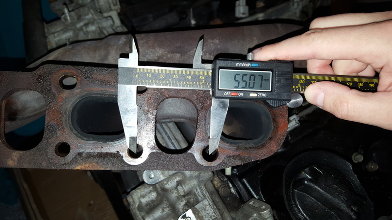

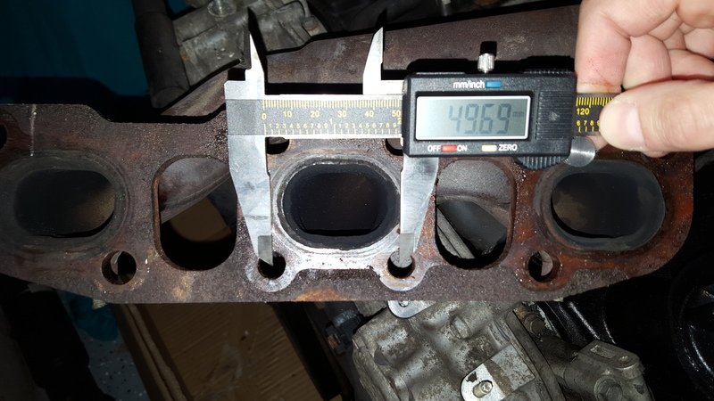

Hey sorry it took so long, but here are some quick measurements I was able to take before junking the motor.

HAHA never mind, I'm too late
