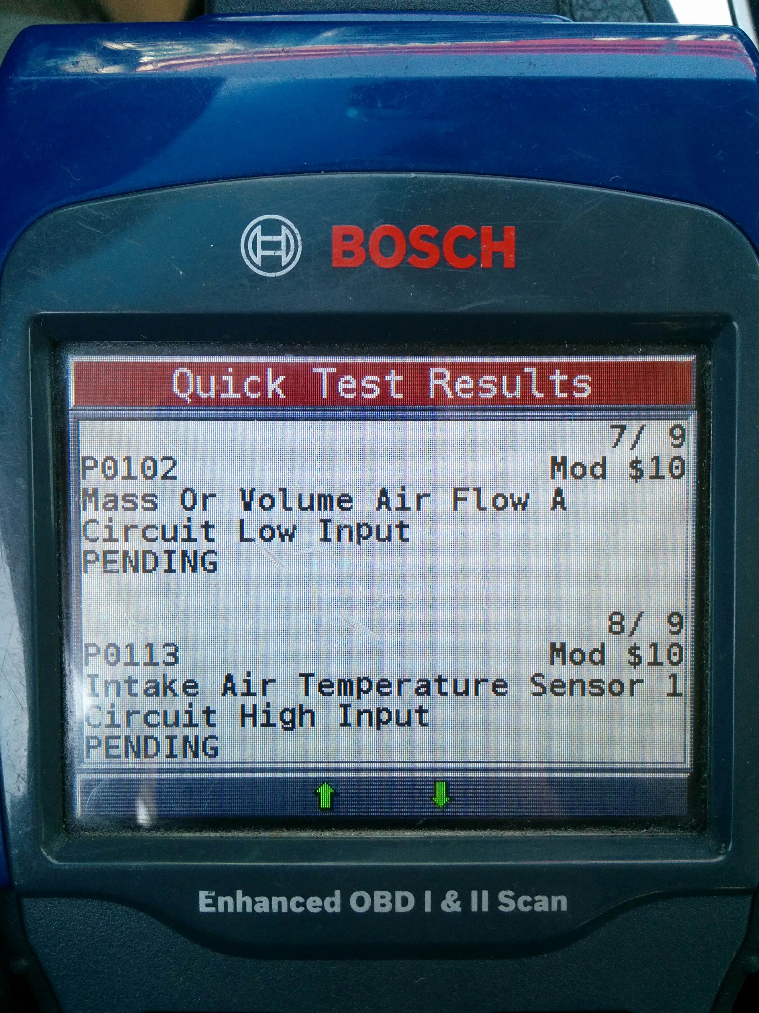

So the OBD-II test returned 5 codes:
- C1130
Engine Signal 1 (The code means that the Anti-Lock Brake System (ABS) control unit has detected that there is problem with the Engine Control Module (ECM).)
- P1564
ASCD Steering Switch (Cruise control)
- P0102
Mass or Volume Air Flow Circuit Low Input
- P0113
Intake Air Temperature Sensor Circuit High
- P0456
EVAP Control System Very Small Leak Detected
The EVAP control system I don't understand. I added a HEET fuel system cleaner to the tank on my last fill up, so something might have gone awry there. The cruise control switch was faulty when I got the car. To remedy the other codes I'll just remove and reinstall the air intake system to see what happens. Any other ideas? Should I just replace the air intake system with a new one?
Any help would be greatly appreciated!

well c1130 is prob your ABS module. but i think you need the dealership diagnostic computer to pinpoint what has failed.
p1564 is prob just a bad steering wheel switch. just need to replace
p0102 clean you MAF sensor and be sure it is plugged in well.
p0113 refers to the intake air temp. if you have an OHM meter check that the sensor is getting power and everything is connected well. also check the grounds.
p0456 it could be just a bad gas cap seal. or you have a leak somewhere in the evap system. check the gasket on your gas cap and be sure there is no debris to cause it to not seal.

You probably cracked intake coupler near the TB and you're taking in air after the MAF. It's old rubber that's seen many heat cycles.
