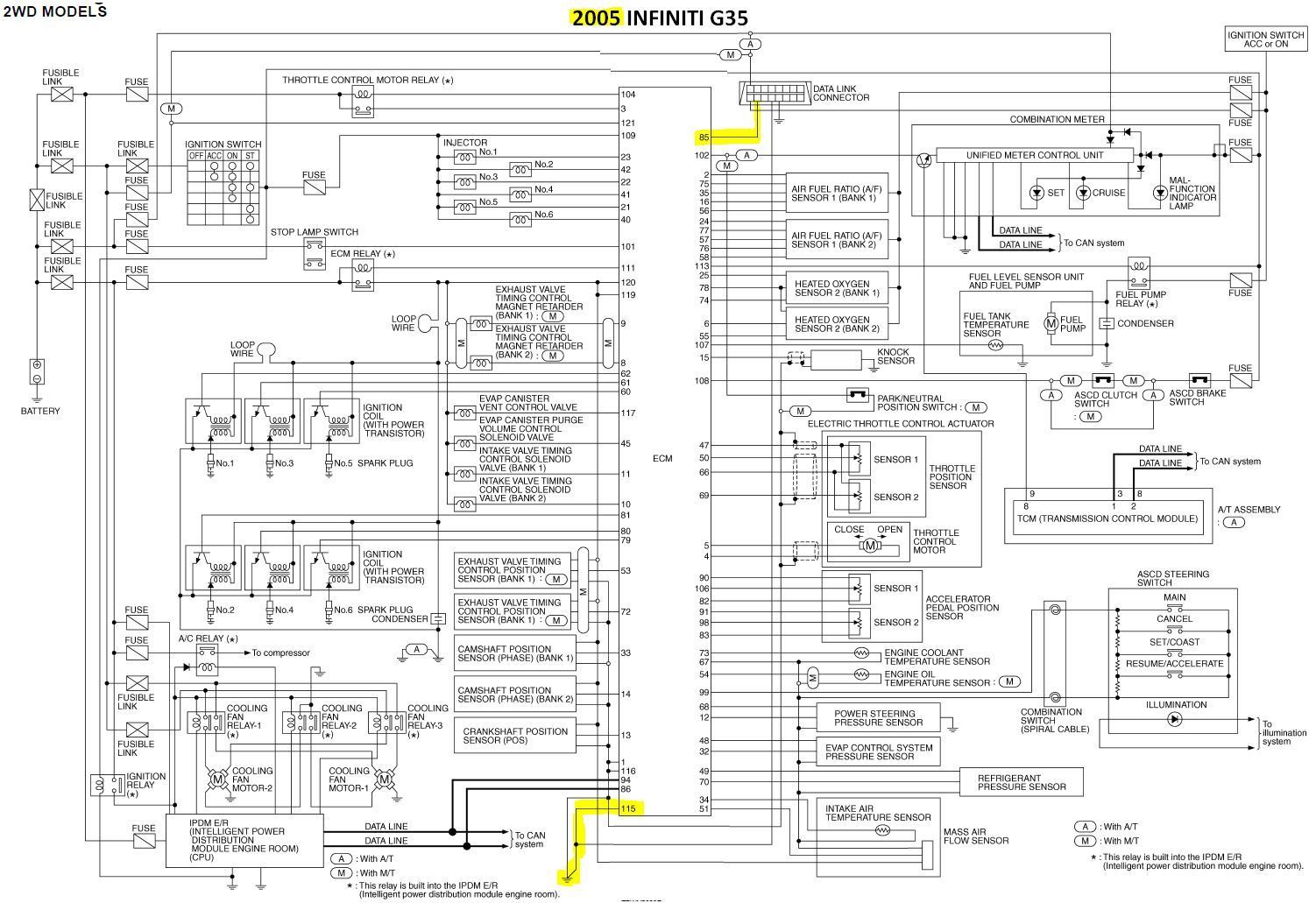

@Amaru , hold on a sec. The answer is in the schematics (I recently went through this exercise).

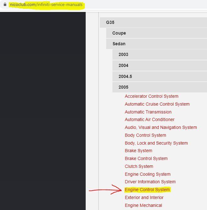

Go to nicoclub.com, go to service manuals, and find your model and the model of your donor.
For now, here's a quick shortcut:
See the problem?

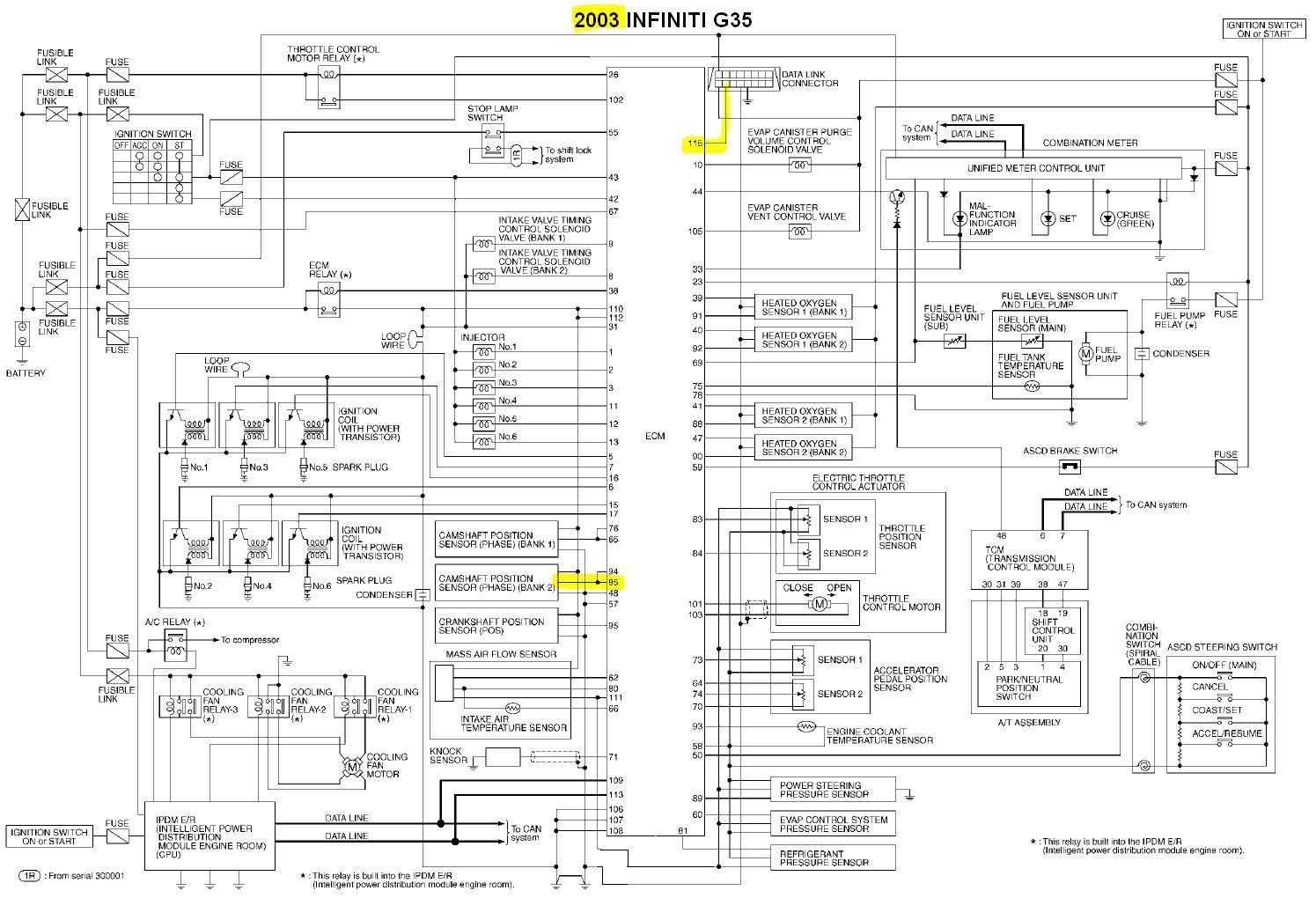

Your 2005 G35 is expecting to talk to the ECM on pin 85 of the ECM harness, but pin 85 of your 2003 ECM/harness is for the cam position sensor. No wonder you can't get any data from your DLC!
But wait, there's more. (It gets worse.) Look at pins 94 and 86 of the 2005 schematic - that's the CAN bus (Controller Area Network. Think of it like TCP/IP, but for car components). So your car is looking for CAN bus traffic on those pins, but what is it actually connecting to on your 2003 ECM? Take a look... coincidently, 94 also goes to the cam position sensor, and I don't even see 86 on the 2003 ECU, so it's N/C (No Connection [not used]). Your 2003 ECM isn't even talking to your BCM because its CAN bus connection is on the wrong pins. And it continues to get worse - look at all the differences in the pinouts of these 2 ECMs. It's apples and oranges.
This will not work. And unless you have a good soldering iron and a WHOOOOLLLE lotta patience, it can't work.

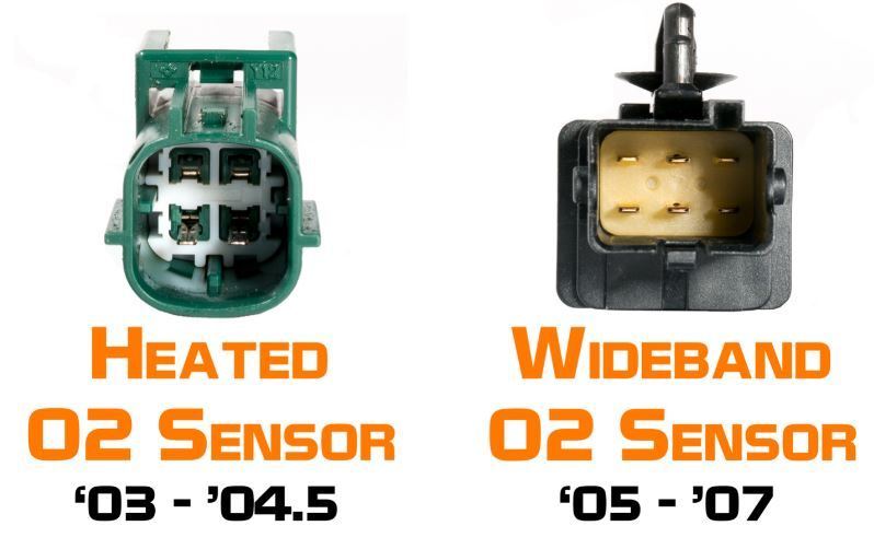

Since you have an 03 engine, it will have the narrowband O2 sensors (on the left). ECM's that are pin-compatible with your 2005 use the widebands (on the right). So swap your narrowbands for widebands. Your 2005 harness will not connect to the narrowbands anyway.
