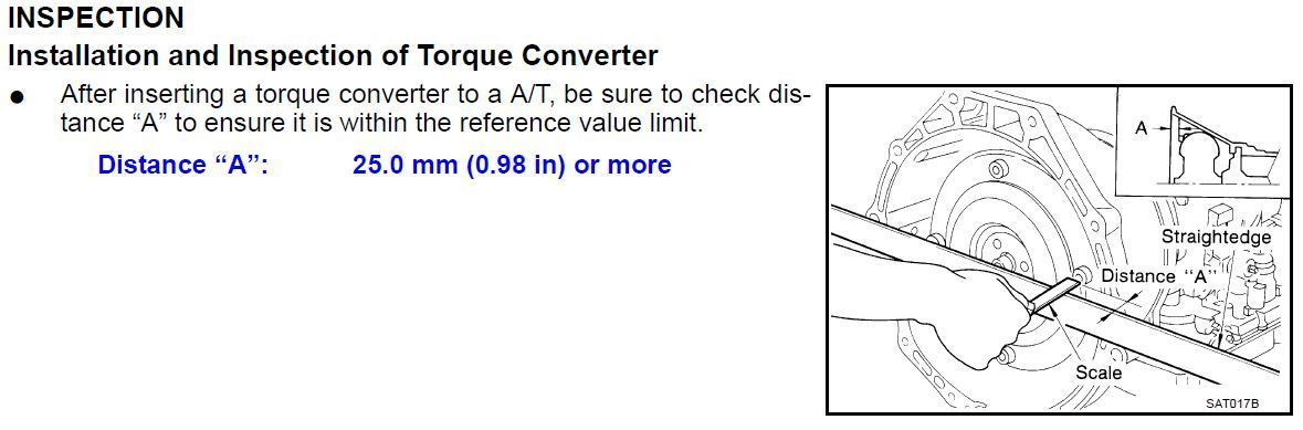

EXACTLY which transmission are you trying to install, get the ID tag off the transmission if you didn't see the vehicle it was pulled from.
There shouldn't be ANY gap between the bellhousing and engine, you should be able to easily mate the two by hand and finger tight all the bellhousing bolts, if there is a gap then something is definitely wrong and you need to pull the transmission back and verify everything is in place. Here is a snippet from the FSM for checking the backspacing on the torque converter once you set it in the bellhousing.

I did, I saw the vehicle and made sure the model numbers matched. Both are model 92X18. I’m sure they are the same transmission. Also, that’s useful info. I’ve figured out how to get it in properly at this point, but don’t want to do so if the pump may be damaged.
