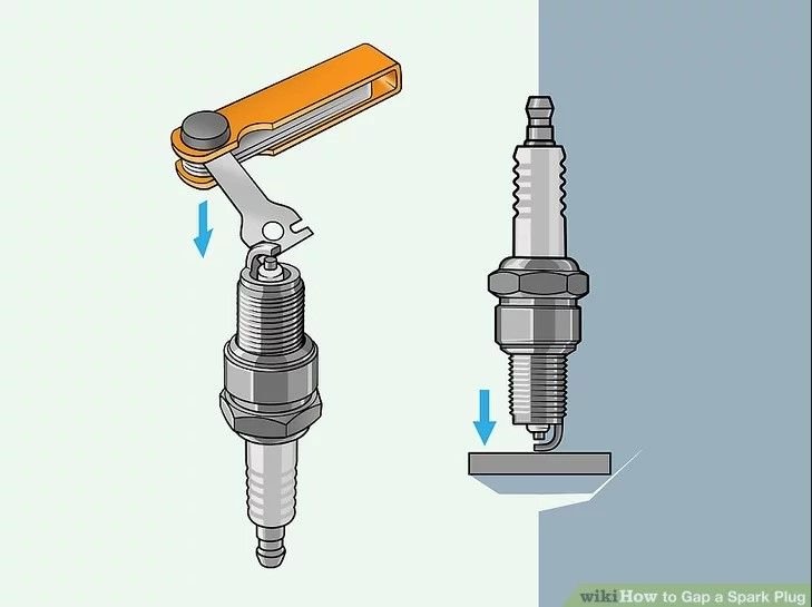

About the spark plugs, you can't use the traditional "spark plug gap wheel tool". That tool is designed to wedge between the electrode (middle part) and ground strap (hook part) and you physically pry the gap bigger. Platinum and iridium plugs have an EXTREMELY small/fragile/weak electrode and you cannot pry on that piece or you will bend it.
That tool was designed to work primarily with copper plugs that have a very large and solid electrode, however you can still use the wheel gap tool as a MEASUREMENT device. In order to open/close the ground strap you need to manipulate ONLY the ground strap, they make a tool that's designed specifically for that as well, it's typically used when you are using feeler gauges as the measurement device.
So yes you can definitely re-gap platinum or iridium plugs, but you cannot pry on the center electrode.
Here are a couple picture examples of the two main types of tool for opening the gap, to close it you just face the spark plug with the ground strap down on a bench or something solid and gently PUSH the gap closed, then open it up to the measured amount, it's very easy to close the gap too far so you always want to OPEN the spark plug gap to the correct measurement since that's easier to be very accurate with the tool.

As for regapping the spark plugs, you should definitely set them at factory gap, no question. Buy the tool to regap them properly or buy new plugs. The gap will open on it's own over time as the plugs age because metal on the electrode is actually blasted off at the atomic level due to the nature of combustion, YOU ARE GETTING IRIDIUM IN THE COMBUSTION CHAMBER and this is completely normal. What that other guy probably meant is that you could easily break off (weaken enough so it snaps off when installed) that small iridium tip with a typical circle/wheel spark plug gap tool.
