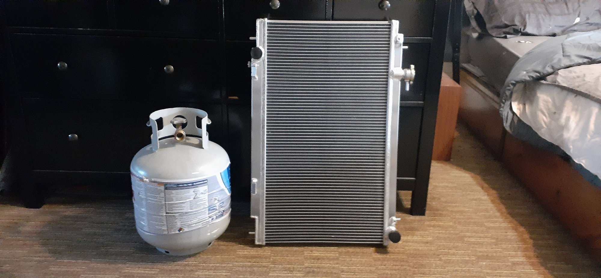

Yea I couldn't believe it either. I haven't seen any more leaking issues since I welded that plug and replaced those thermostat bolts with some bolts that will actually grab the block. But I'm going to be tearing down my entire cooling system for one last time to install all my upgrades at once.
- Pathfinder mod
- Silicone heater hoses
- Z1 heater hose bleeder / temp adapter
- Silicone radiator hoses
- 50mm thick boy radiator
- Z1 1.3 Bar Cap
- Possibly the radiator hose temp sensor adapter
- Temp gauges
Heres a pic of the new rad (propane tank for scale)
Old Jan 2, 2021 | 05:36 PM
  #41
cleric670's Avatar
BANNED!!!
Joined: May 2017
Posts: 14,837
Likes: 2,497
From: Washington State
Coupe 6MT Premium RAS
Don't bother with the radiator hose temp sensor, that's racecar stuff for standalone ECU's with dual stage fan control and stuff like that. All it's going to do for you is add another potential point of failure.
