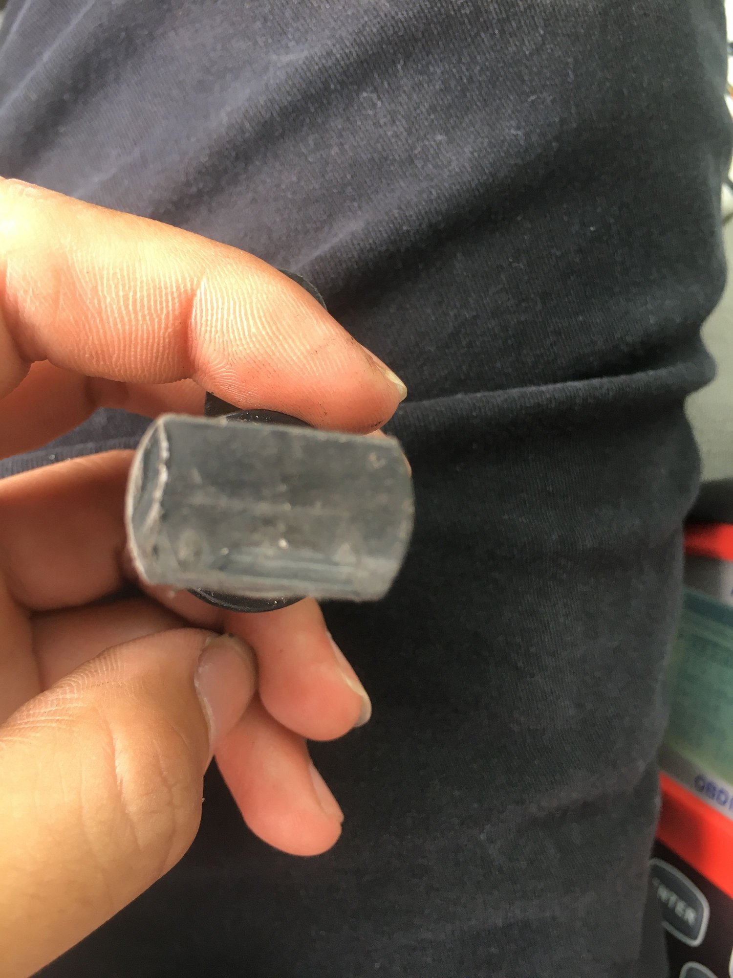

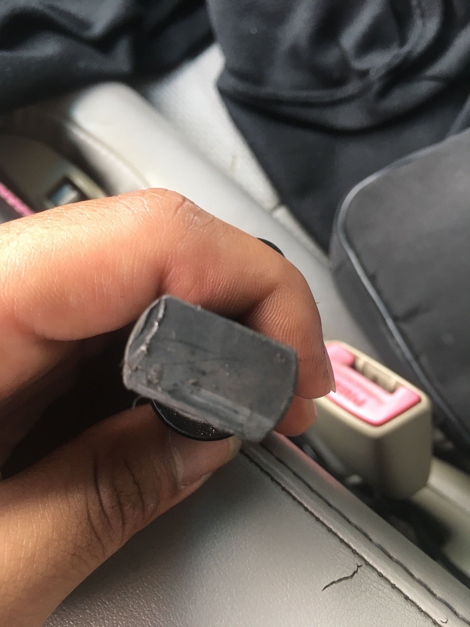

New note, Engine started normally but right when it started, it died out then went back to its “Not starting with sensor in” mode, I cleared codes and still nothing. I did notice though that there is a slight groove going down the front. If anyone knows if driving without this sensor is also dangerous, pls let me know as I need money to fix this problem.
also here is an picture
I think you should get the car up on jackstands and inspect behind the flywheel ring gear for damage. You're going to need to either rotate the engine from the crank pulley or by bumping the starter. If you do it by bumping the starter just be sure you are on FOUR jackstands so the drive wheels aren't touching, pull the fuel pump relay and then start the engine and let it stall out from no fuel. This way you can get quick controlled bursts on the starter.

Again, thank you cleric for helping with the technical stuff and I’ll be back soon to give an update. Am trying to find a AT flywheel and hopefully that fixes it and I pray to god I didn’t just Blow another Engine…
You lost a bolt/s on the flexplate that holds it to the crankshaft, I can see lateral play at that camera angle looking through the CKP sensor area.
