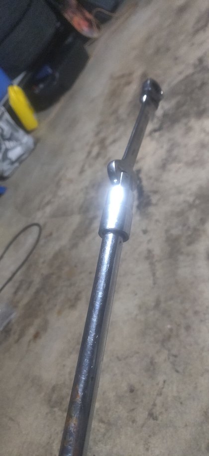

Tools you will need:
14mm ratchet wrench is a must. At the very least get a set of husky, cheap amazon garbage won't work, you need something that can handle a lot of torque.
14mm stubby wrench that you can grind down
Real skinny arms

14mm hex bit socket to extend the ratchet wrench. You can try to get away without it by just using a 1/2" drive extension, but 1/2" is 13mm so the amount of play it has probably won't work with how little room you have in the engine bay.
Wobble extensions
Impact universal
14mm stubby wrench extractor
Deep socket bolt extractors (I have been using Irwin for years with nothing but praise for them)

Now you can attempt to remove the top nut of the engine mount with a stubby wrench with the 14mm hex key like in this guy's video:
However, if it goes as stupid for you as it did for me, it just rounds the nut. This is fine, it just means you'll have a lot more work to do. You can try getting an extractor stubby like he does in the video, but I didn't have time to wait for one, and didn't feel like spending $25 on a wrench.

Try to use the first method of turning your stubby into a crowfoot to loosen the nut. If you round it off again, no big deal, except its a very big stupid deal.
Now you'll have to remove the mount bracket by taking out the 4 bolts holding it on, which sounds simple, if only every single thing wasn't in the way. The worst one is probably the top rear. Use those skinny arms of yours to get the ratchet wrench on the bolt. Then I used the 14mm hex key with socket extensions as a breaker bar.

The top front is almost just as bad as the top rear since its waaaay up in there, and the stupid oil cooler line is in the way. The oil filter definitely has to come off, along with the top oil cooler line. So just take that off, make a mess, and shove it out of the way. Wrap your ratchet wrench in some electrical tape to help keep it from bending, otherwise it's going to be an absolute pain getting the wrench on the bolt and keeping it from coming off. Use the hex key breaker bar again.
