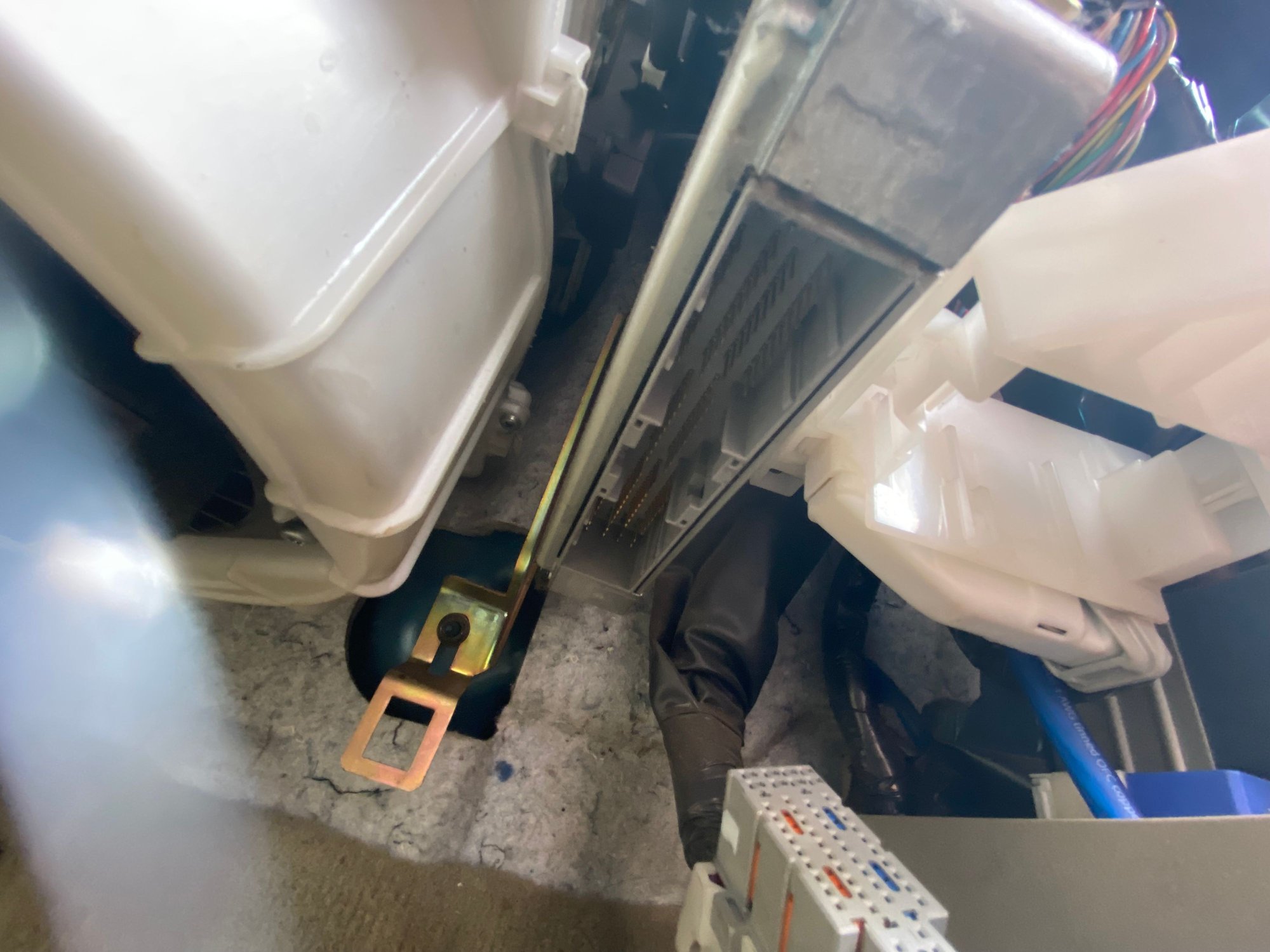

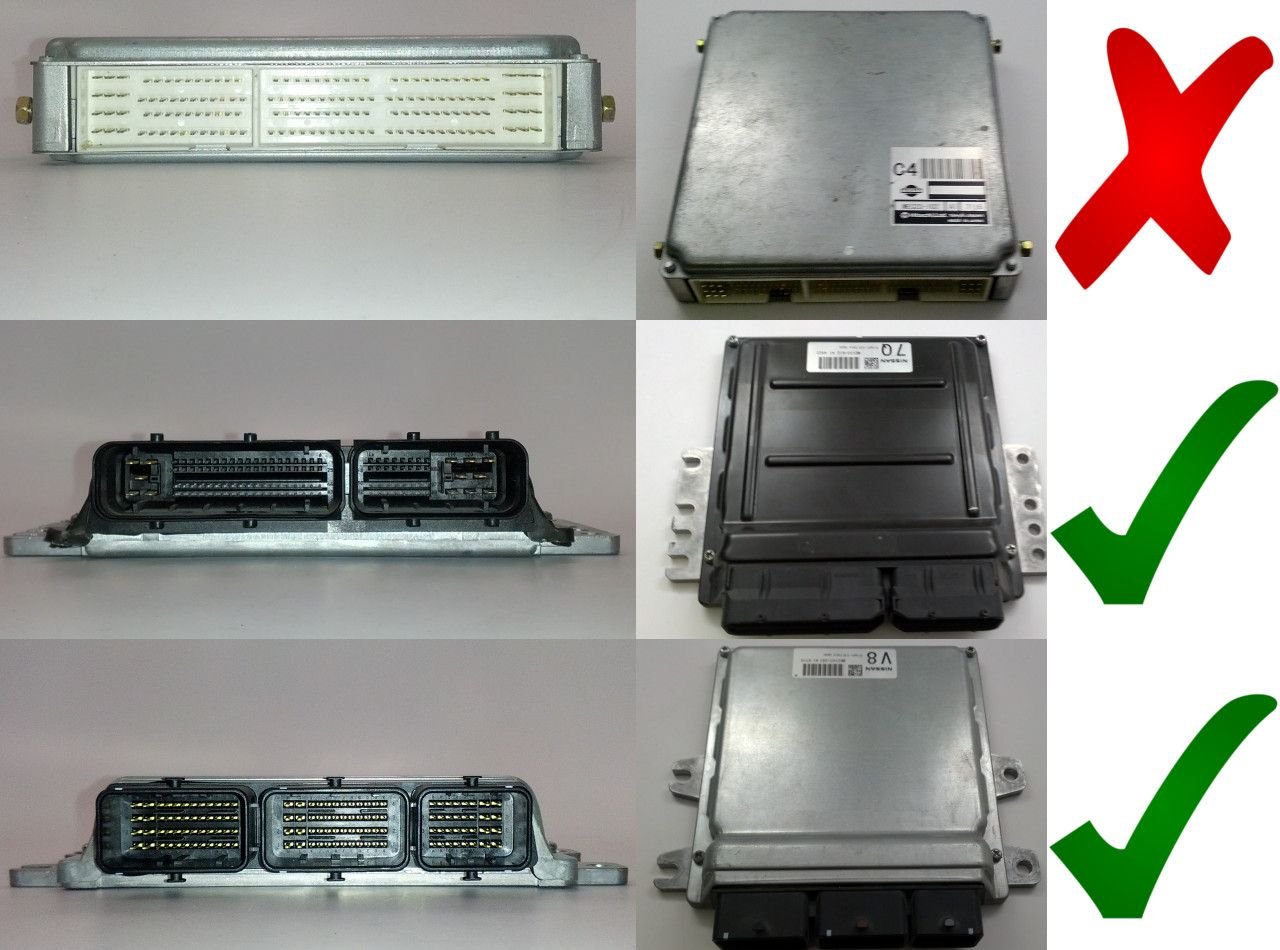

Have you looked at the actual ECU and checked which one you have? Only SOME of the 03 sedans are untuneable.

Mine has the top one, single plug.
Is there any sort of piggyback that would allow this ECU to be tuned? Or could an ECU swap happen?
I really want to get this thing tuned at some point, I was hoping for it to be my project daily.
