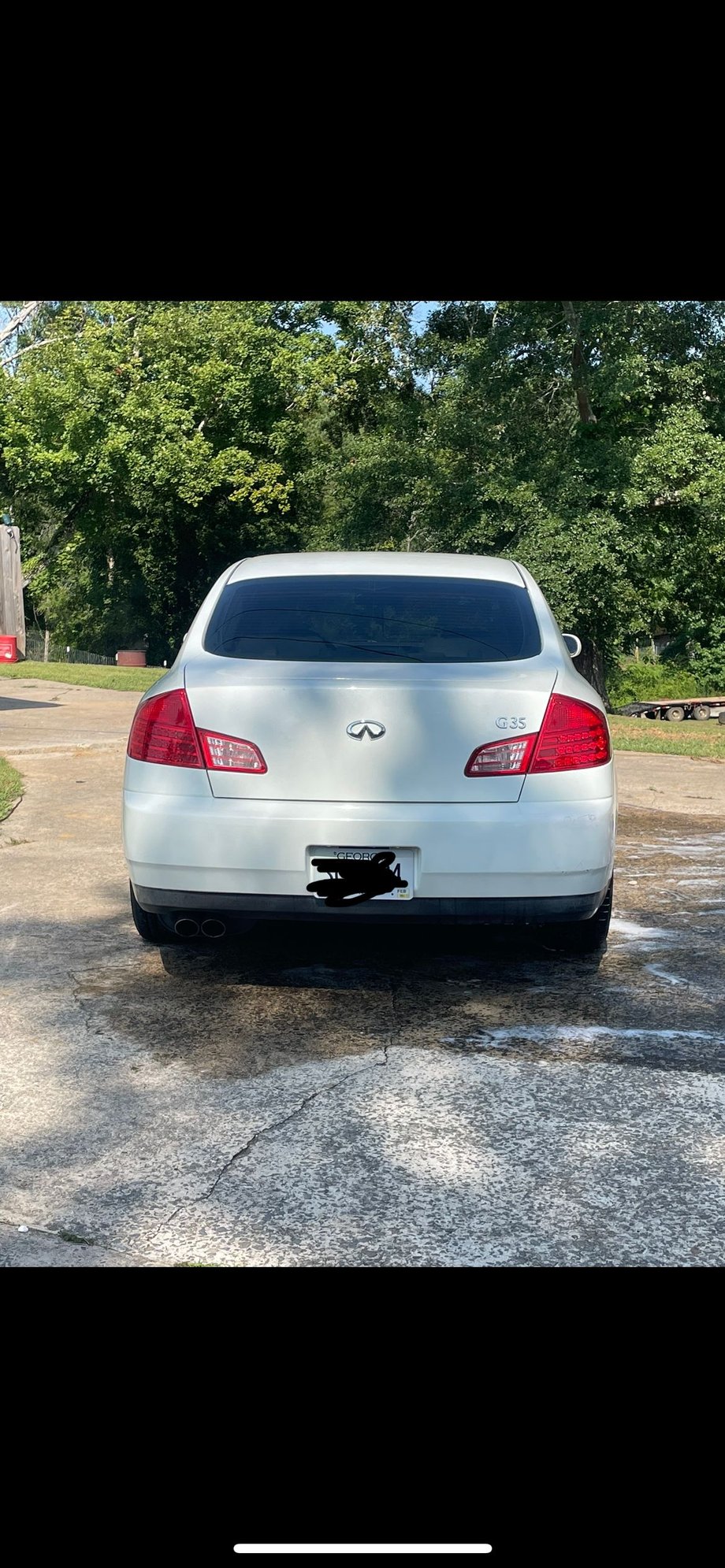

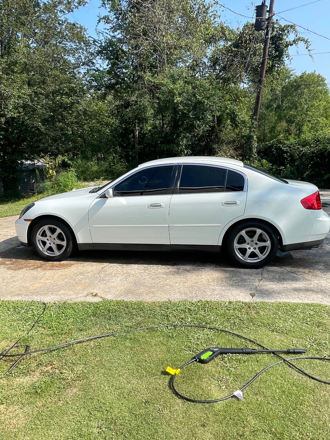

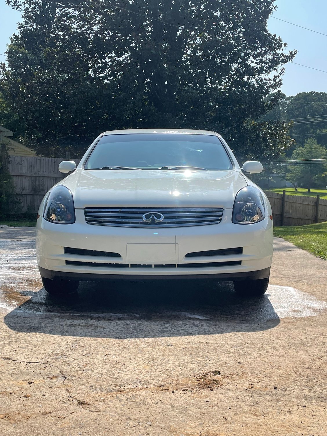

2004 g35 sedan with 115k miles
no dash lights got code for p1716 and u1000
transmission shift rought first or second time running through the gears then runs like butter! If i were to try and floor it from a light its gonna shift bad and sometimes slightly sloppy down shifts as well but for the most part runs and shifts great.... someone plz help befor i buy a new trans for it
