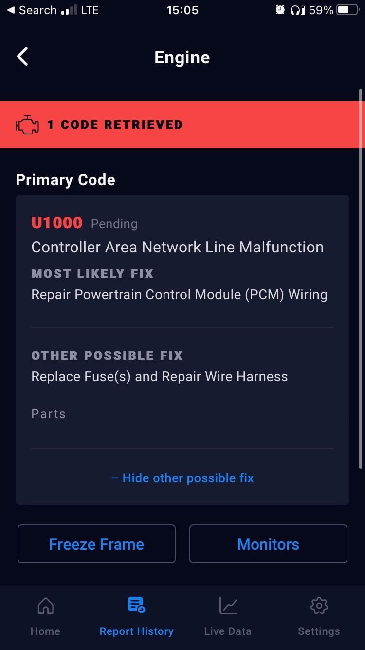

I have a 2007 G35X with a U1000 code, my 1st 2nd and 3rd gear all shift weird, but the rest are fine. I’ll attach an image of what the code says, any possible fixes would be greatly appreciated, as I don’t want to ruin my transmission.

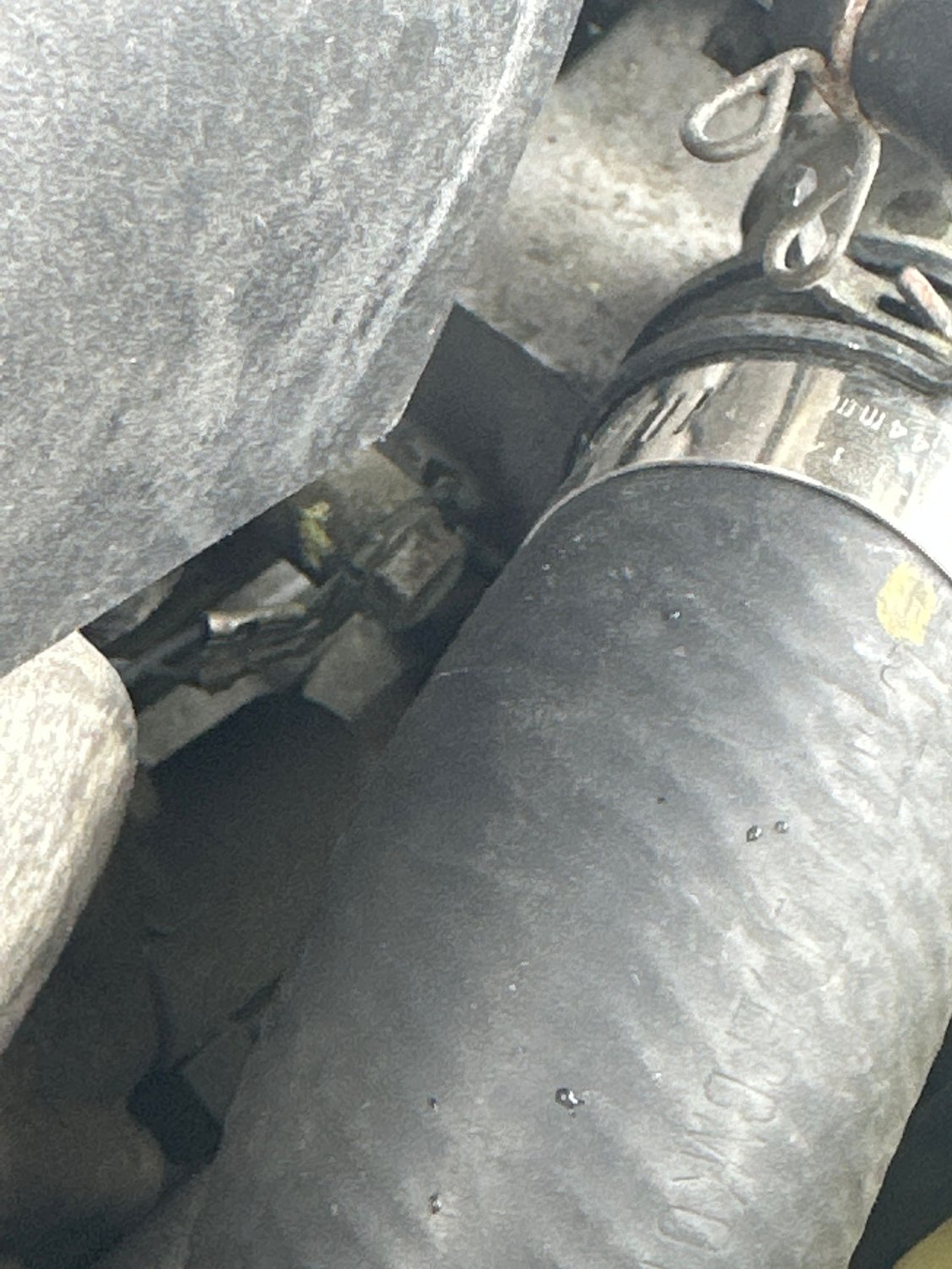

Is this the ground you’re taking about? Or is it a different one further down?
