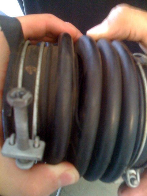

The rubber part for my stock intake is ripped. Anybody have this part for sale?
This:
WTB: Intake Rubber Part-fqsk1l.jpg

you just need an OEM intake bellow?? why not just replace with a solid silicone coupling...will be smoother air flow without that in there.

Yea, the intake bellow is exactly what i need/looking for (didn't know the official name).
and not sure what the silicone coupling is. u mean this?
http://image.made-in-china.com/2f0j0...icone-Hose.jpg
how does it work? just remove the rubber and put that silicone hose instead? sorry about the Qs, i truly don't know anything on intake parts

yes correct. you can just replace the OEM intake bellow with that coupling. I believe you will need a 3" coupling.
you may want to get a hump hose since they are alittle bit longer. This sit below has any color you want.
http://www.siliconeintakes.com/index...737ab73b45c552

Appreciate man! I'll look into those
edit: when u say 3" do you mean the inner diameter?
cause they have 3 dimensions
inner diameter
outer diameter
outer diameter hump

measure the inner diameter of your OEM one...I believe they measure inner diameter. I was trying to see if I had one laying around which I dont unfortunately.
