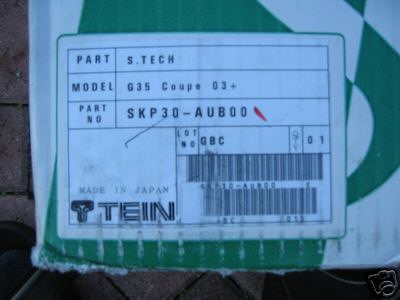

do you have G or Z s-techs?

Attachment 81447
these are for a g35
