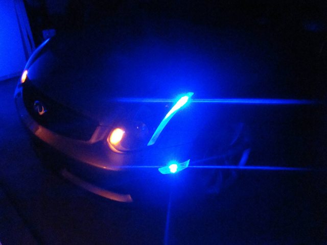

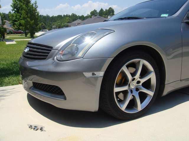

Quote:
Lookin good. Is that a light in the clearance strip? (I think that's what it's called). I didnt know there was a light there...Originally Posted by Mark2K8
Put in my $15 clear corners I got from ebay
Quote:
Yea. I replaced the original one with an LED. If you don't have it, you prolly got projectors (I believe they dont have a clearance strip light)Originally Posted by Sen
