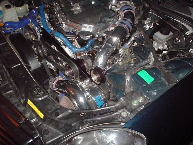

Vortech SC
Fully Built Sleeved block and bored to 3.8 liter & and Fully built top end with stainless steal valves and the whole works.
Stillen headers, race pipes, Fujitsubo y-pipe, 3.5 inch pipe to HKS muffler.
HKS F-CON Standalone w/ A/F knock amp and HKS Navigator. 3 defi gauges
12psi boost
Hell yah I would do it again. The torque and power in this car is a MONSTER. Well worth the money, many headaches, and problems. This is my first custom import I have done so live and learn. I am sure if I did another one it would be much easier.
I wish I could have done mine for 6,000. With going back and forth w/ parts and different shops I think I am around 35,000 plus the cost of the car.
