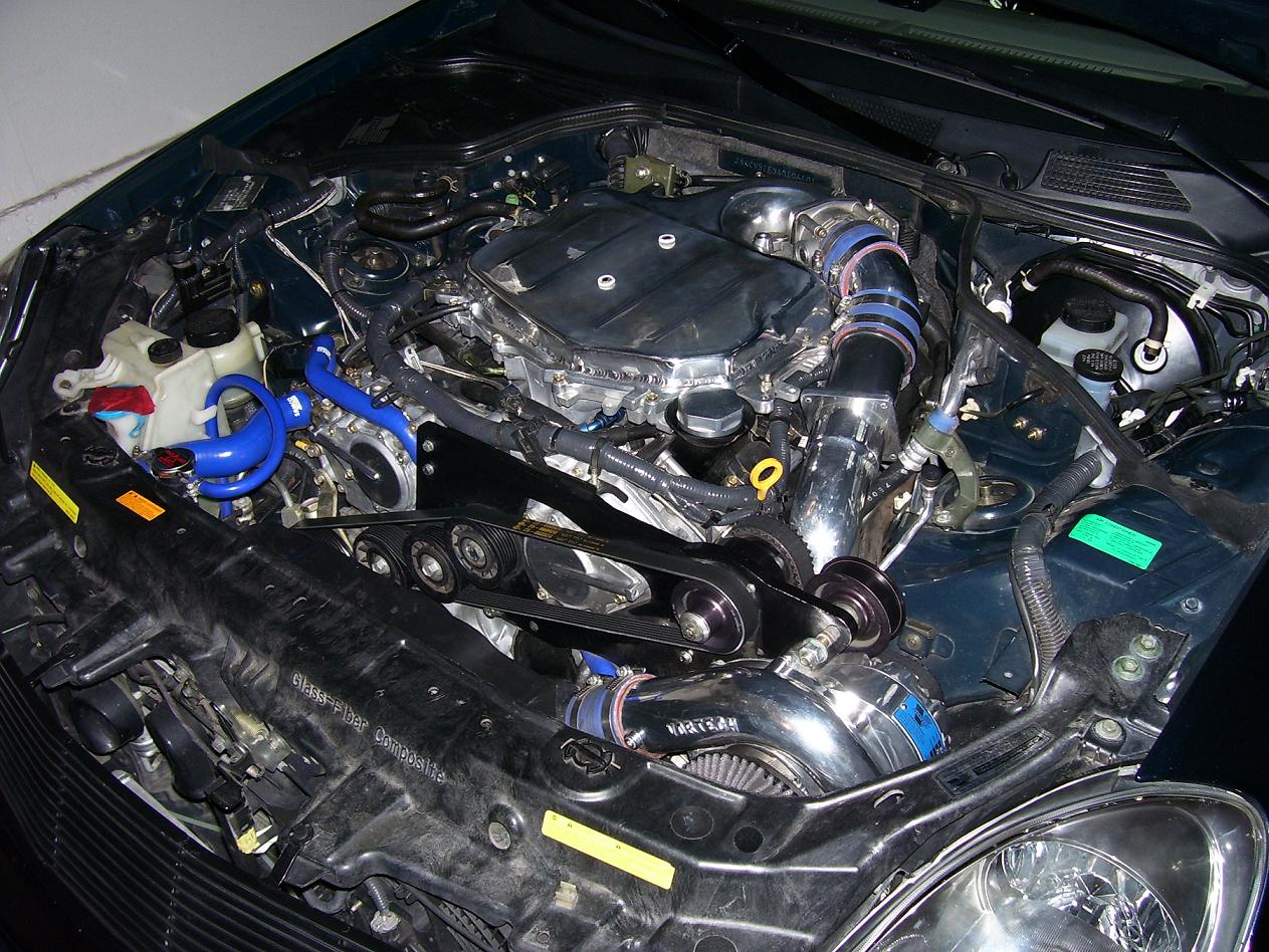

Built.. SC.. Sedan
Fully Built sedan
6MT swap
Vortech SC
9.5psi
and a lot of mods.
Hopefully get a smaller pulley soon for 13psi boost...

wow, sick. any reason you didn't go TT after building the engine? can you give us some details of the build? this is my plan when i get the car itch a few years down the road

Nice Vortech work! What did your motor build consist of, parts, cams, port and polish heads, compression ratio, etc.? What size pulley are you going to try to use for 13psi.?

Wesco pistons
GTM rods
JWT cams
81
New fuel rails, injectors, fuel pump, and return.
Hopefully the 2.62 pulley if that will make 13psi. Probably more like 12psi.

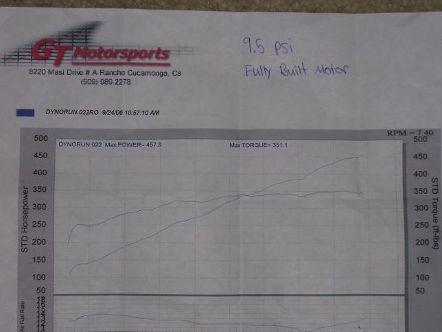

its alittle lean up top 13s. Try to get SAE numbers from them but still really good numbers for only 9.5 psi.

Can that SC make up in boost what you lose in compression? I know turbos can make up for the extra space with boost, but how much power do you make now and how much will it make on 13psi?
I was going to go with 8.5:1 comp also, but am trying to be talked out of it by the shop with my ProCharger.
There is a dyno posted. About 450whp at redline. At 13psi, and redline set to 7000rpm; I predict around 525-540whp depending on the tune. I really want to switch to a TT setup. Then my torque curve would be alomost 100wtq more than what it is now. Probably the JWT w/ the upgraded turbos.
Yeah I know. My injectors are running 120% at redline. If I want more boost I would have to switch the injectors. Really my motor is set at 6500rpm redline for safety reasons.
