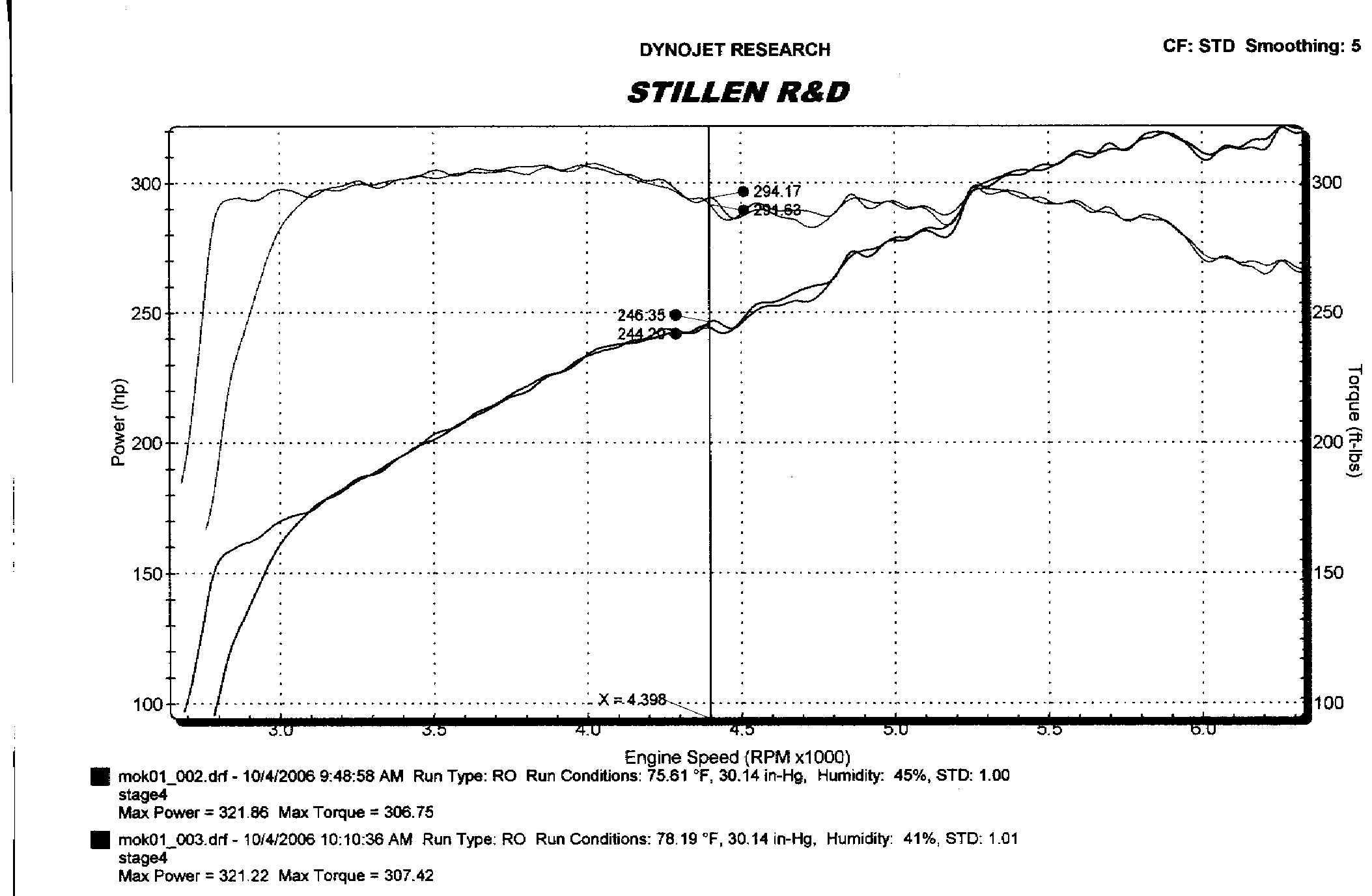

Well...i'm running a stg IV and i'm barely putting down 320rwhp. My dyno graph shows that at midrange, i'm losing power where the root SC counts the most, the car is probably pinging and the knock sensors are kicking in and retarding timing. I took the car back to Stillen and they told me the SS box that i have, "cannot" control timing, so the SS box on a vortech must be a better box then the one on the Stillen's. None the less, i'm just looking for a better EMU to help with the pinging before i snap crackle and pop!!!
BTW...the quote i got for a CMJ stage1 return fuel with 440injectors and with the FCON IS was a whopping $5500. But is it worth it so my motor won't blow???

If your knock sensors are pulling the timing, then they're doing their job. I think instead of a EMU, you need to find out what's causing it to ping. If you can correct that, you should get a little more power.
When you had it dynoed, what was your a/f? Maybe the SS box you received from stillen is defective or maybe their's a problem w/ the 7th injector.

I hear you on the wasting money part. For that much i can try to sell the SC and use that $5000 to buy a TT I guess the key to these FMU & EMU is to find one that will control that Aux injector. The only one that i know of is the FCON IS. Although alot cheaper then the VPRO, but still expensive.
I took the car to get tuned at Stillen since the SS box is locked, and they did not mention anything to me about a bad injector. It's a matter of fact, the midrange area, they started to dump more fuel in to see if i would get more power or see whether the knock sensor would go away, but it didn't. They were scratching their head...I'm left with trying to figure out what the next step is.

before jumping ships to the hks fcon wither the is or the v pro, we need to find the root cause problem of the lost power in your mid range. from speaking to you several times over the phone and reading up on this here on the forum. I'm not sure how they came to the conclusion that the car is detonating, were they mothering knock sensor voltage ,logging timing ,or using head phone and listening to knock ,I doutgh that they have done any of that .but I could be wrong .
my point is we need to diagnosis first then execute. if the car is in a fact detonating ,which it will not be difficult at all to confirme. we need to look at the possible causes ,it could be a simple as excessive carbon deposits on the top the pistons. carbon can be a big factor in engine detonation .also it can be cooling system deficiency which also will do it . at the end of day putting a better engine management is a never waste of money considering saving you engine and making it lost longer .

Hey Sam I hear you and thanks for the feedback...I haven't jumped ship on the FCON just yet, but I've dumped so much money in this SC already, and my level of frustration is almost at its ends that I'm almost ready to sell the car!!
But to answer your questions, no one has done any indept analysis on the car, no head phones, no data logging except for the dyno. I guess that is where GTM comes in.
