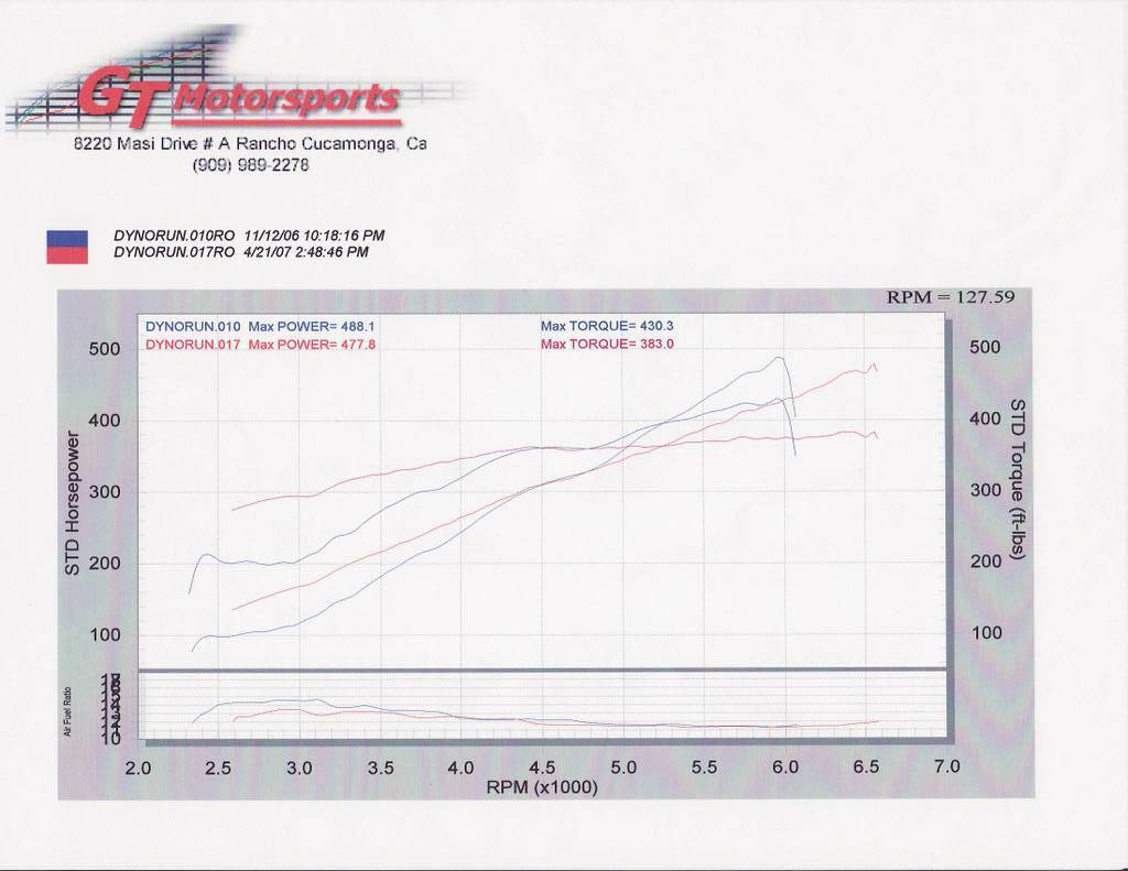

that particular setup that they were trying to shoot for was considered unsuccessful and not reliable at high reves with high boost so Dsport gave up and went with a JWT TT kit.
It would have been great if it worked, but it would snap belts every time they went for 7500+ rpms and if they kept it to 7000 rpms or less, it'd still manage to snap the belt after whatever many pulls even at 6000 rpms. And these were extreme kevlar belts with steel reinforcement
here's one of its last dynos (the blue/gray graph) but it stops at 6000 rpms
It reached 508-513 whp by reving to 7500 rpms

Sentry ......you're showing one dyno graph that Sam posted to try to make your setup shine better . He didnt post a graph showing anything past 6000rpm . Dont sit there and say the car only made 20 or so more whp from 6000rpm's to 7500rpm's .

Sentry's last dyno was on a DynoJet so if he put it back on his original dyno , it would come out [ on his 455whp tune ] real close or maybe less than the 430whp he claimed here and the 420whp he claimed at my350Z....probably around 410whp .ANd his 477 tune would be around 430whp
The problem with trying to make over 500whp with a blower and this motor . I feel it is mostly parisitic loss . Meaning - its taking to much HP away trying to turn the blower which is getting harder and harder to turn as psi rises . And the motor just isnt big enough to pump enough air to over come the HP loss turning the blower.
