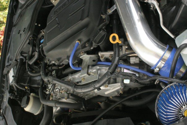

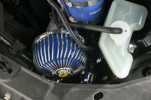

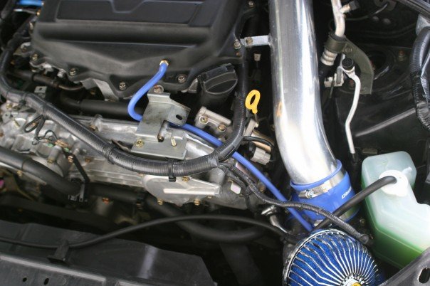

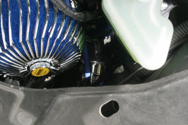

I just found out my "compression surge" issue was due to the fact the guy who installed it disconnected my 200$ BOV because it was stalling.
I had him hooked it back up, thought because I was tuned it would fix it.
Stalled twice in 10 miles.
I was in DRIVE so that seemed like it might have had something to do with it.
But This is a really nice BOV, and sounds orgasmic, I would really like to keep it, But I wont if I keep stalling.... Do I just need to stay in tiptronic or what? I have attacted pictures of my set up just in case...
TIA
Eric
EDIT: I just called japtrix, They said that I should bring up the idle, but I've never honestly heard roger so confused!!
Attached Thumbnails Greddy TT 5AT BOV = Stall?-n70702205_30343734_7247.jpg   Greddy TT 5AT BOV = Stall?-n70702205_30343735_7534.jpg   Greddy TT 5AT BOV = Stall?-n70702205_30343736_7838.jpg   Greddy TT 5AT BOV = Stall?-n70702205_30343737_8139.jpg

Is it after the maf? If so, it's discharging air the maf already counted. So the ecu gets confused and stalls.
Maybe you need an ecu tweak to whatever engine management you are using

can you adjust that bov so it doesn't open under low boost? My 240sx was doing the samething until I adjusted the bov, now it's fine. As mentioned above the MAF is counting for air that is being expelled before it make it to the intake causing a stall, which in my case seemed to be a problem at low speed/low boost conditions - just my guess though, I am no expert

No it's pre-MAS by those pics. Still strange that you are having that issue. Try moving the idle up to 700-800 and see how that goes.

if the BOV is too close to the MAF (even if it is ahead of the MAF), it will cause issues. The MAF is very sensitive to turbulence, and having the BOV really close to it could cause a stall issue......

When I unhook it, it runs perfectly very smooth. It such a rough ride with it hooked up.
Can you tell from the pictures if it needs to be moved farther down?
