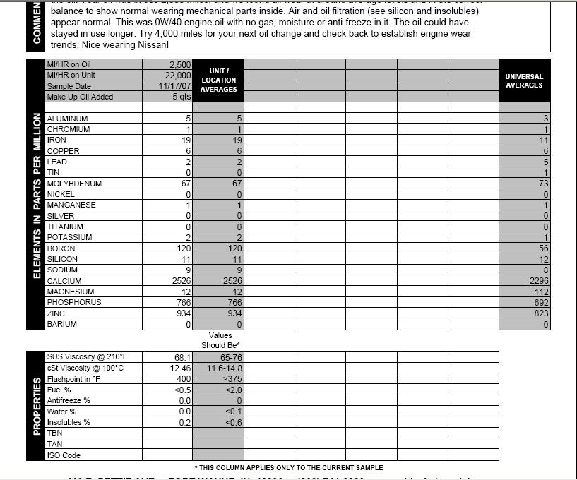

I'm running 8psi (365whp) and I have 22000 miles on my car now. I put down 2500 miles on the Mobile1 and it was already black. That 2500 miles was 85% hard driving and lots of WOT pull. If the oil hold up then I'll be impress!

Ok, here is my result after using Mobile1 0W40 for 2500miles. I have a Single Turbo running 8psi around 360whp on my Stock Motor. This 2500 miles are all hard driven and lots of WOT Pull since I was adjusting my A/F for the Winter Driving. I only drive my car on the Weekend so I go WOT every chance I get My oil was almost black when I changed them so I was surprise that it did hold pretty good. My car is pretty much stock except the Turbo and Mrev+. I think I can still push a few more hundred miles but I'm happy to change my oil at 2.5K miles

I think I can go with 4k miles on 0w40. Did you guys did some test if your oil are actually holding? Heavier weight dont mean it is actually holding

You can order some free test. They will send you a container that you need to send back to them with payment of $22.50 (Check or Credit Card). If you are going to do a lot of test then they have a package that will save you $5+ (depend on the package)
http://www.blackstone-labs.com/free_test_kit.html
