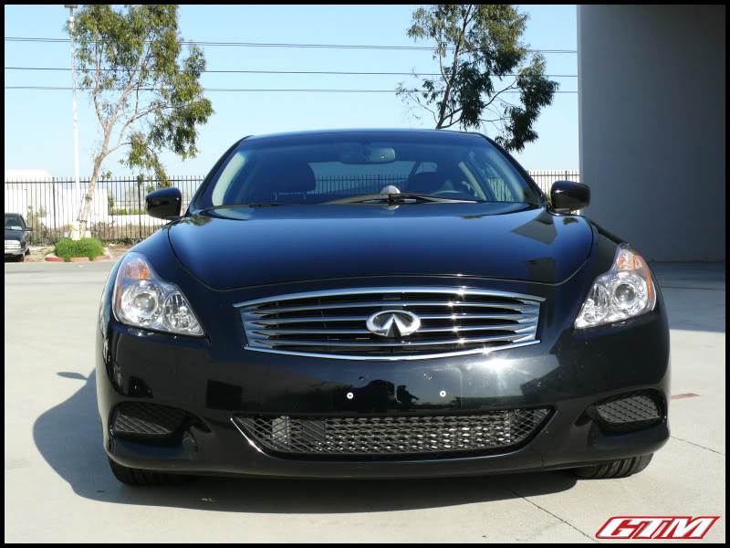

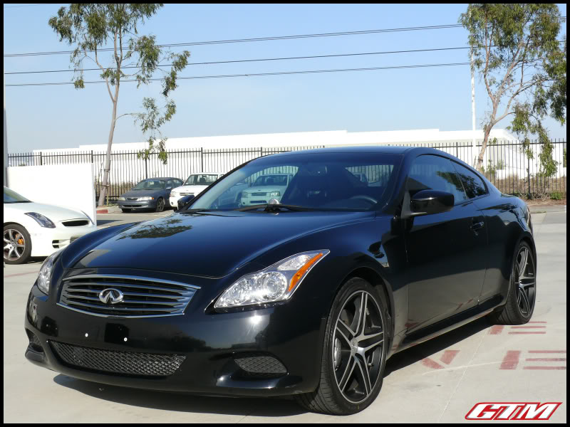

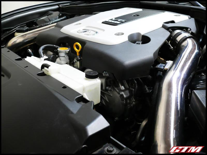

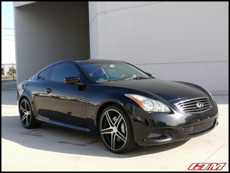

This car came in completely stock (minus the wheels). We installed our GTM G37 Complete Turn-Key Twin Turbo System, along with a few other supporting mods and this car is making awesome power at only 5 PSI!
The new VVEL engines are truly amazing, although difficult to tune for the inexperienced, they flow so much more air than the previous engines, which makes them an awesome power house.
We are not yet done with the tuning on this car, these are only preliminary numbers on waste gate pressure, keep in mind this car is an automatic as well so the drive train loss will be higher than if it was a 6MT.
Hopefully we will have some new graphs shortly with a nice increase in power output
2008 Infiniti G37 S Coupe

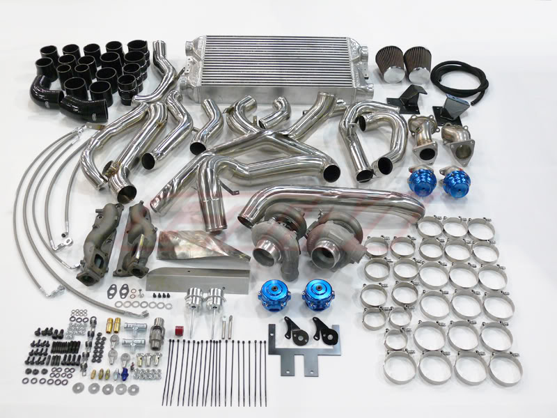

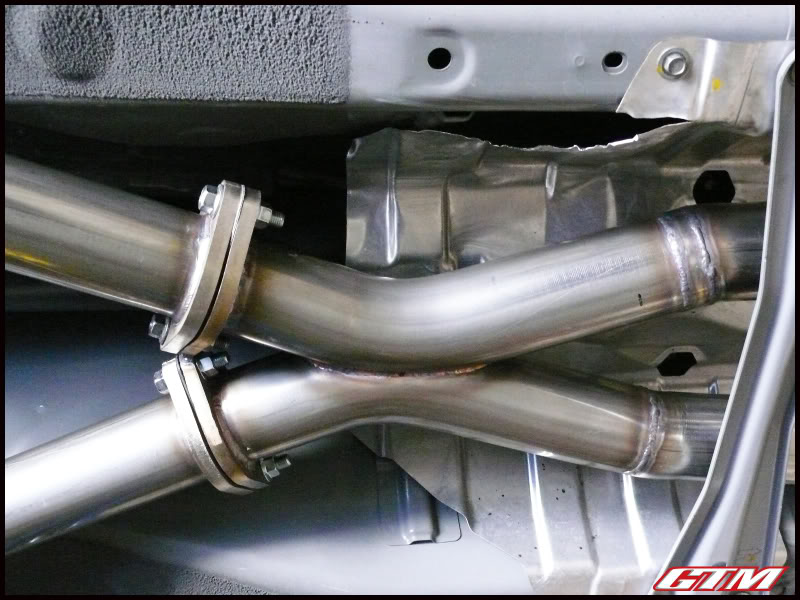

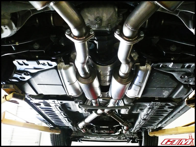

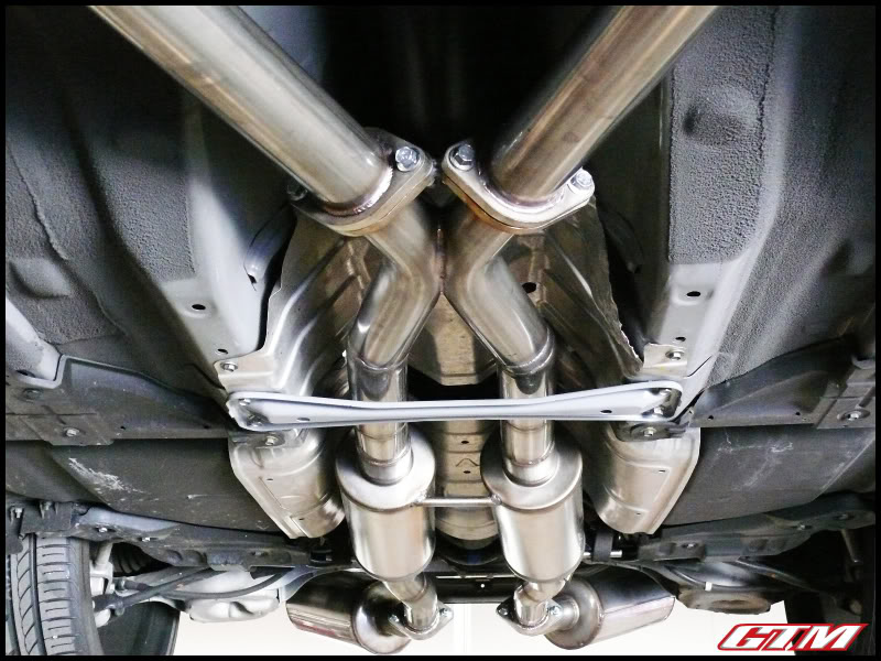

-GTM Turn-Key COMPLETE Twin Turbo System
-GTM 2.5" Test pipes

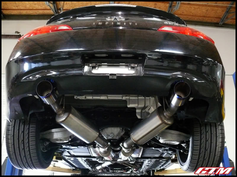

-GTM 2.5" Cat-Back exhaust
-GTM Automatic Transmission Valve Body modification
Enjoy the pics, and please let us know if you have any questions!
-George

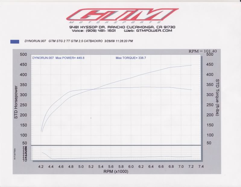

91 Octane fuel, Automatic Transmission, 5 PSI:

On ONLY waste gate pressure (5 psi) it put down 445 whp 338 ft-lbs tq. Nothing but exhaust and kit.

I love everything about that car....except for the wheels. Very nice job on the O2 extenders on the downpipes.

450whp 5psi 5at!??!? I love the HRs
Great set up, nice #s, good job guys.
