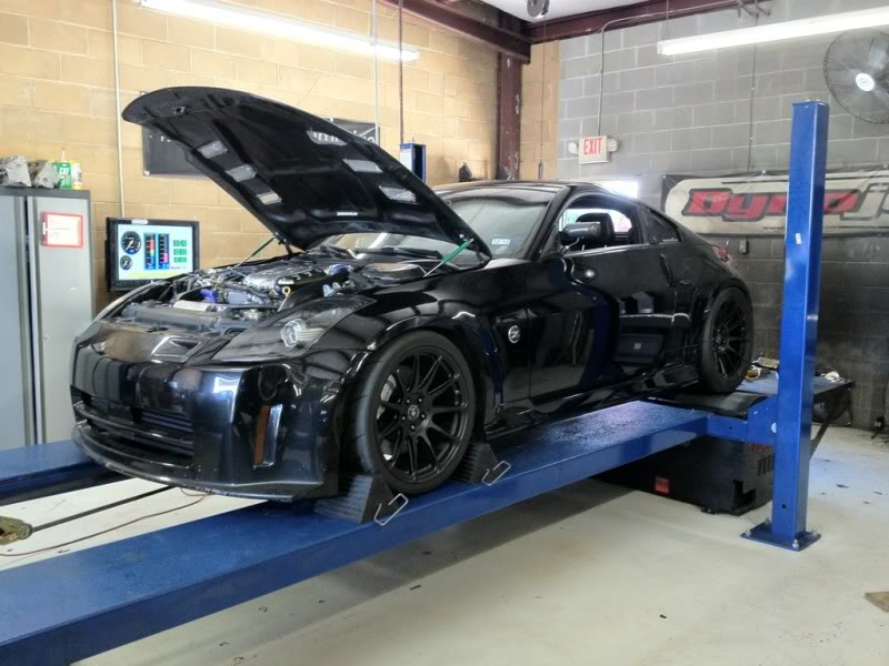

Old Jul 31, 2012 | 12:51 AM

jonsg35's Avatar
Joined: Apr 2011
Posts: 136
Likes: 9
From: SA, TX
^^ Sic!! Good looking Z bro...

G35 Sedan
Monster

options13's Avatar
Joined: Jan 2012
Posts: 123
hoollly ****... well done.

Robert_K's Avatar
Posts: 324
Likes: 15
From: Spring, TX
Thanks!

Lone Wolf's Avatar
Joined: Nov 2007
Posts: 3,982
Likes: 140
From: Fullerton, CA
Loving the meaty tires!
