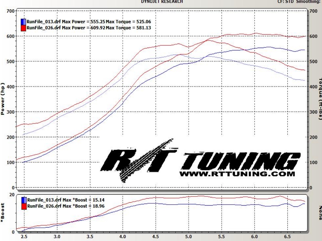

Originally Posted by Robert_K
I think 650whp would be a stretch. LOL We're going to do the race gas tune for dyno numbers and to have for when I do go to the track.
650whp is not a stretch at all. One of my customers just made 610whp with a Boosted Perfromance Stage I single turbo kit. This was a Precision 6266 T4 .81 a/r housing turbo, with a simple short block build. No head work, stock DE cams, stock DE intake manifold:
Vince (tuner) told me that the tune (93 pump) was conservative, and that he felt like there was still 30whp left in the system with and a couple of more PSI. I think that if this customer had the .96 a/r housing 650whp would have been no problem at all.
The stage II kit comes with a larger 67mm turbo, and I am confident that 650+ whould be a reasonable estimate of max power on pump gas.

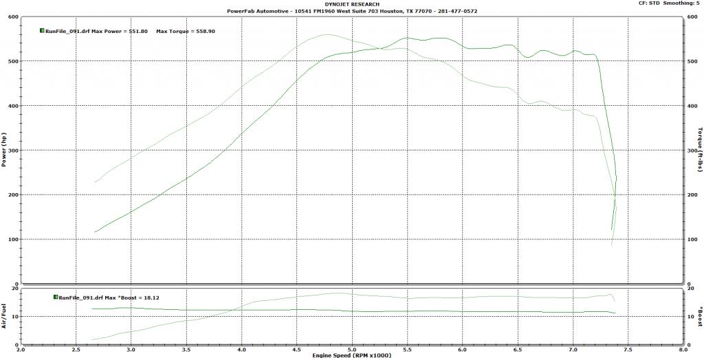

Woke up to this email.
Originally Posted by PowerFab
Had to stop at 16psi 540whp/530wtq since the Haltech decided to turn all the injectors off for some reason and they will not come back on. Waiting on a answer from Haltech.
Old Nov 2, 2012 | 10:29 PM
  #179
Robert_K's Avatar
Posts: 324
Likes: 15
From: Spring, TX
Car finished out at 551whp/558wtq peaking at 18psi in the midrange and dropping to 16.5-17.
