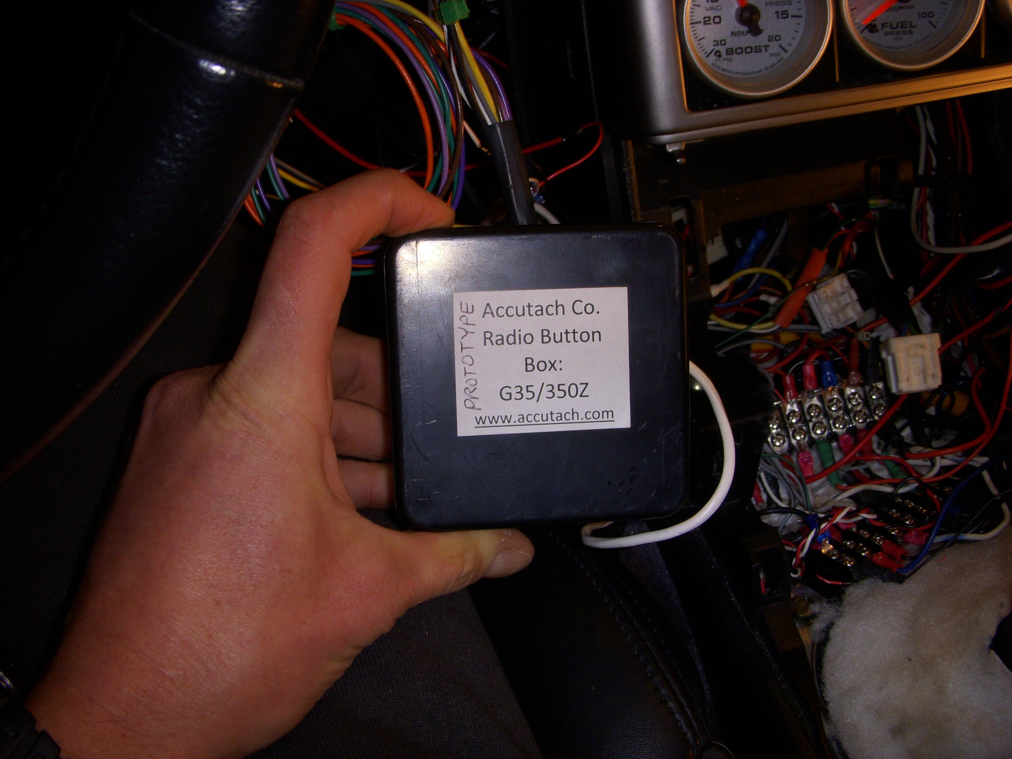

After sending him some resistance values and wiring info, he sent me a prototype box. And it works perfect.
Install is super easy. Took maybe an hour with all the solders.

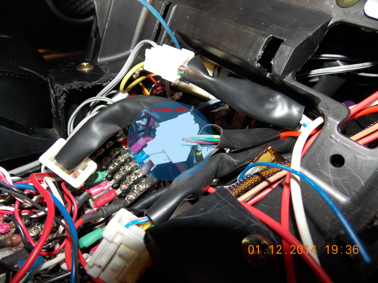

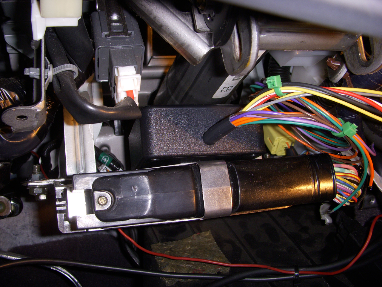

In the G35, just pop the bottom of the shift console up. With an aftermarket radio, the harness you need is unplugged already and easy to get to. Terminal M39

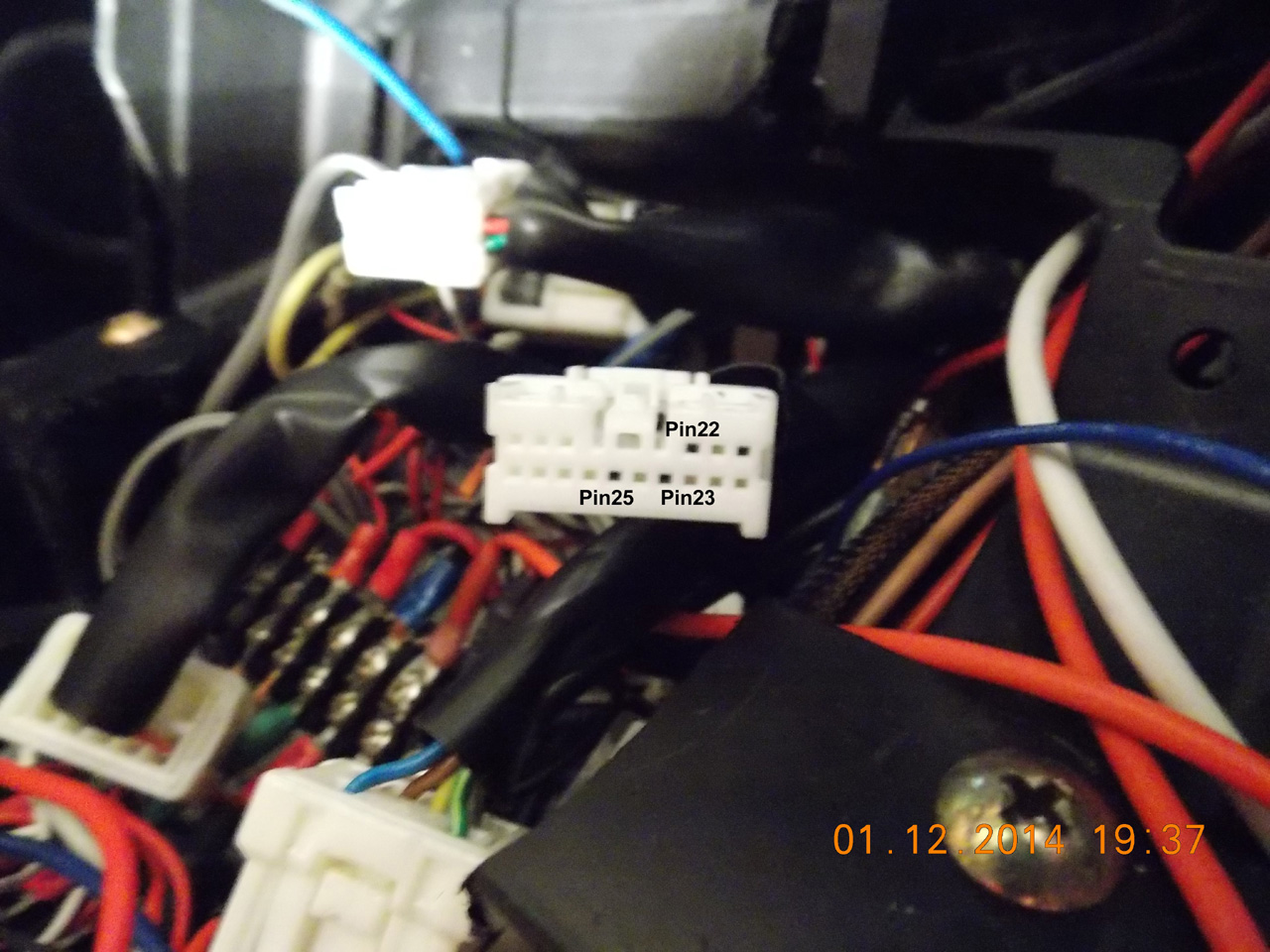

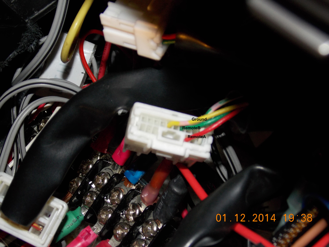

Just connect RemoteA pin 22 and RemoteB pin 23 to the Accutach box, and run a ground wire to the ground pin 25.
Then run power and ground to the Accutach box. I used some velcro to mount the Accutach box on top of the VDC control box under the steering wheel.

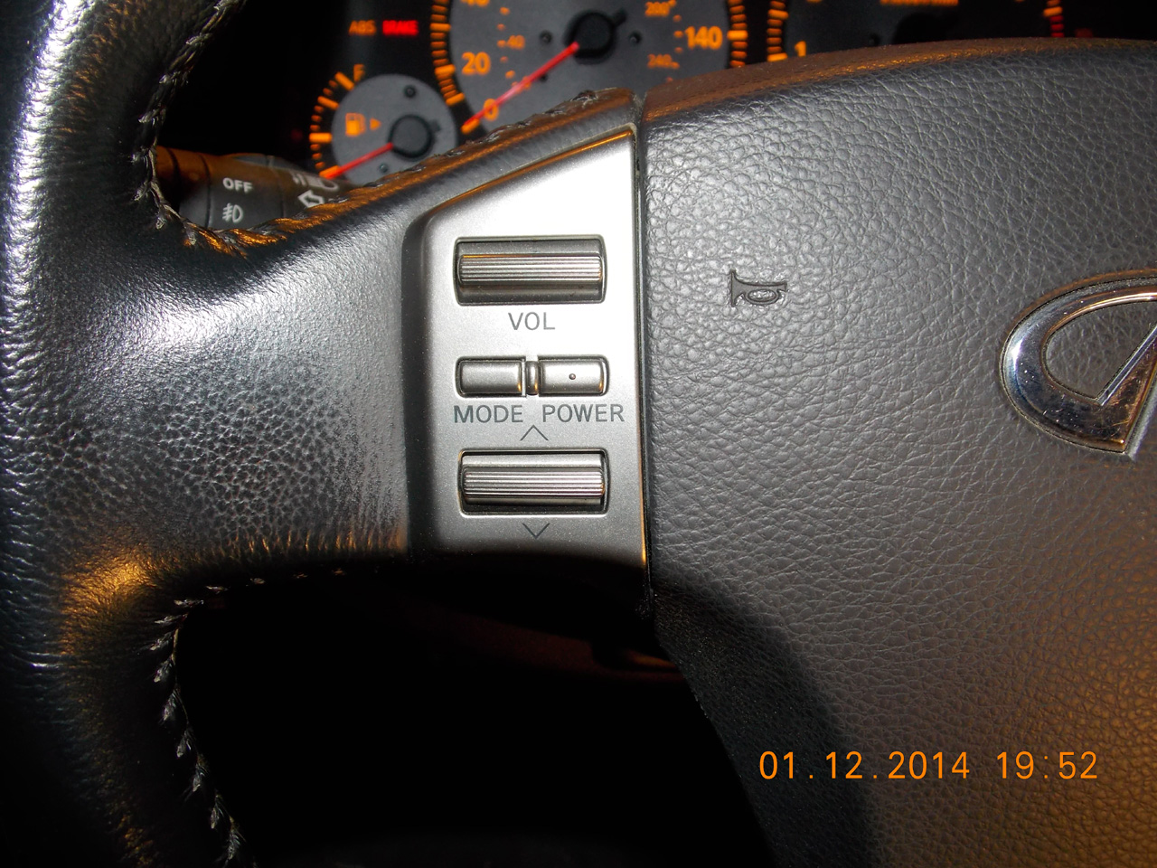

From there you have 5 distinct switches for Vol+, Vol-, Mode, Power, and Seek+, Seek-
I am using the switches for rolling antilag and scramble boost. But they can also be used for anything like nitrous purge, line locks, 2 steps, lights, machine guns etc.
