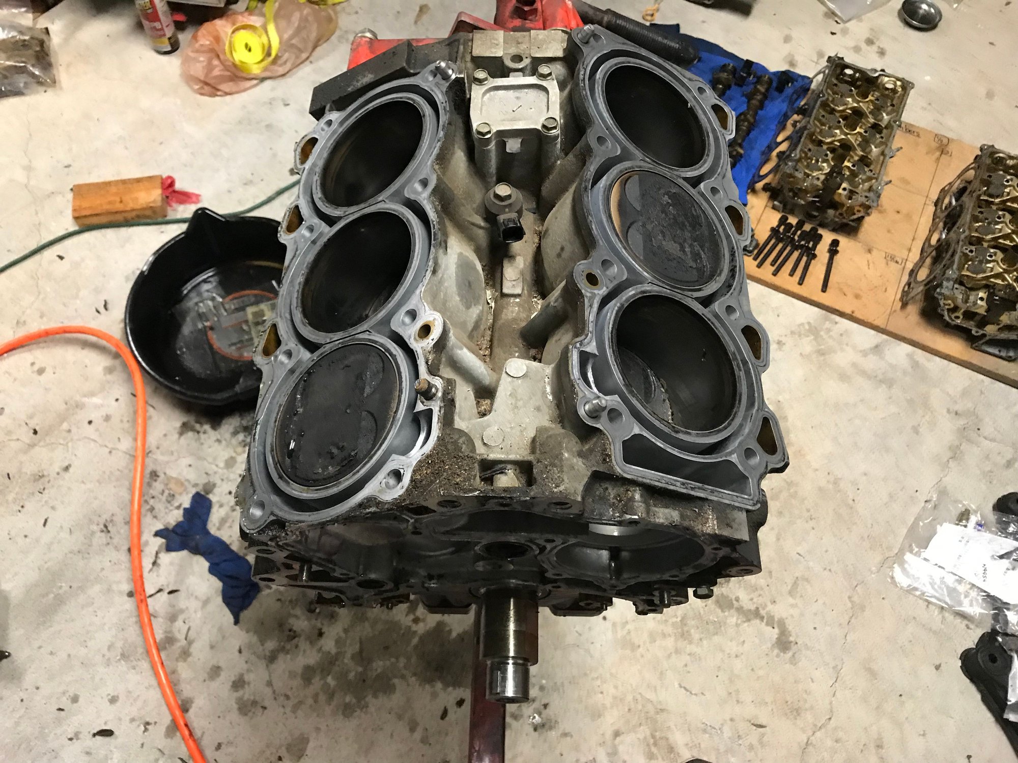

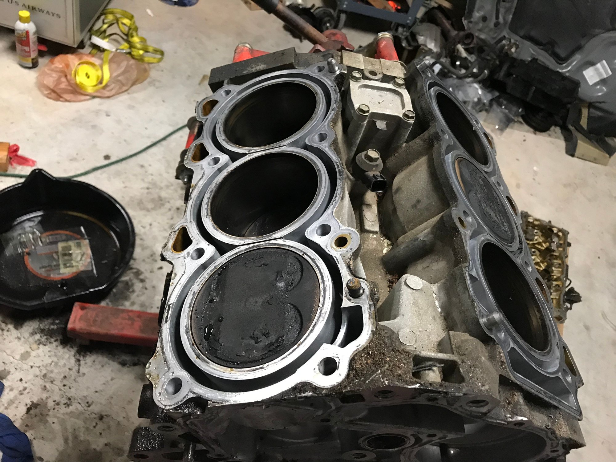

Block and heads are getting honed/ decked atm. Will be picking them up by this Friday. First time rebuilding a Vq35de.
No obvious damage here. Machine shop will verify this hopefully
Cylinder 2 had rod bearing spun.
I have .5 in clearance atm

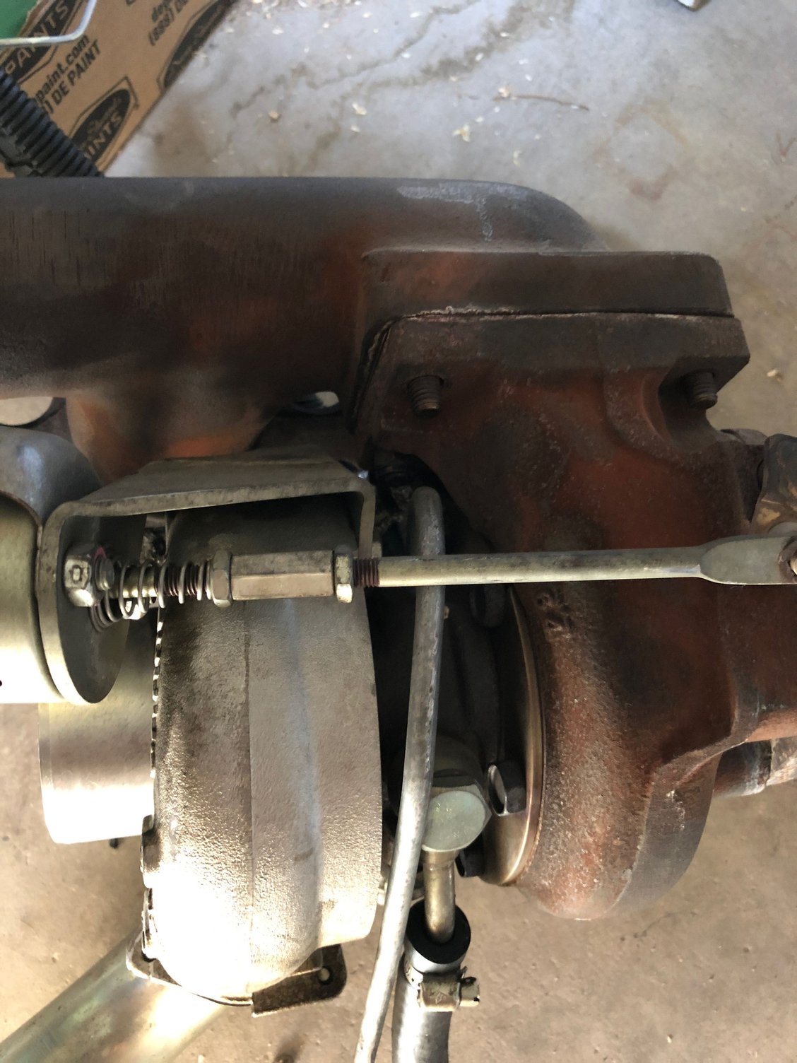

It finally fit!!
The driver side Wastegate needs to be moved forward with a custom bracket. Or just smash the crap outta the frame.
Barely fit. But I have enough room to wrap the manifolds.
i posted this a few weeks back and no one knew how to fit gt2871r turbos on jwt manifolds. The posts that I found were general answers like jwt makes special housings to fit the manifolds. So I bought some spacers voila. They fit. It’s 1/2” spacers and longer double ended studs from eBay.
I will weld the Wastegate brackets (from my gt2554r turbos that came with the kit) onto the existing inner bracket. Or.. it’ll have to be hammer time and knock a clearance notch onto my frame.
