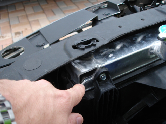

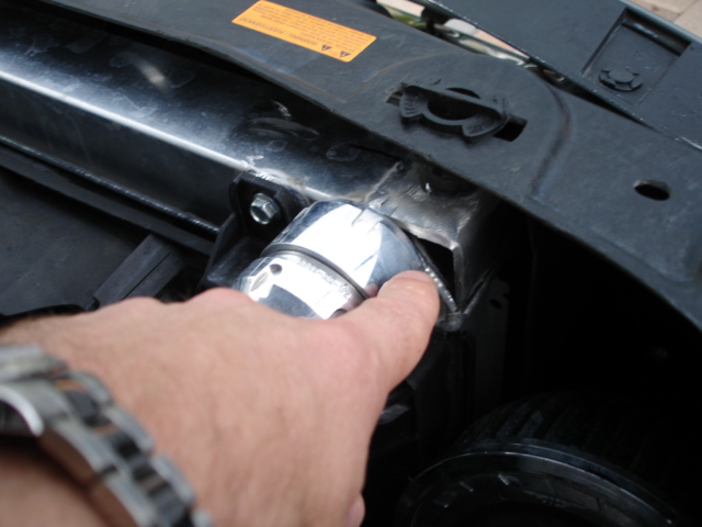

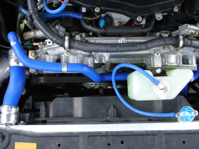

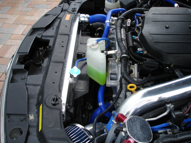

Get a 350Z PE radiator. It is a direct fit other than the top mounting brackets. It costs little more than the Koyo, but in the end after you pay for the extra labor on the koyo they will cost about the same. The fans or shroud do not have to be cut in order for the unit to fit correct.

GMAN what did you with the top mounting brackets to make the radiator bolt up properly?

It seems like most people have the mounting pins cut off and rewelded. However, my shop fabbed up some polished brackets out of some ~0.75" square aluminum.
If you need a place to source the aluminum brackets you don't have to look further then your own front bumper.... There are roughly 6 to 8 small strips riveted vertically to the front bumper. I drilled out the rivets, cut off the mounting tab, drilled some holes and my installer polished both brackets for a very stock look.
