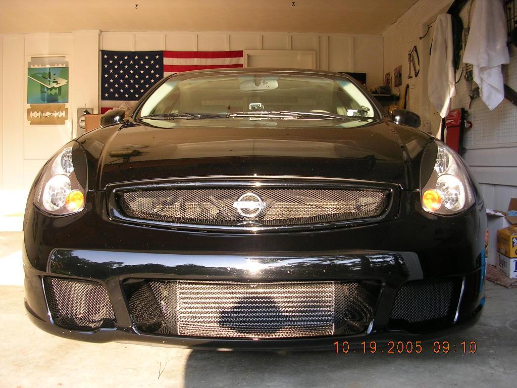

Originally Posted by PhxBlue
Id like to get those holes somewhat covered up, I just havent decided what I want to use yet.
Your car is looking good!!!
I ordered some mesh from Drew at Custom Automesh and covered mine....
It keeps the squirrles out of your intercooler....
