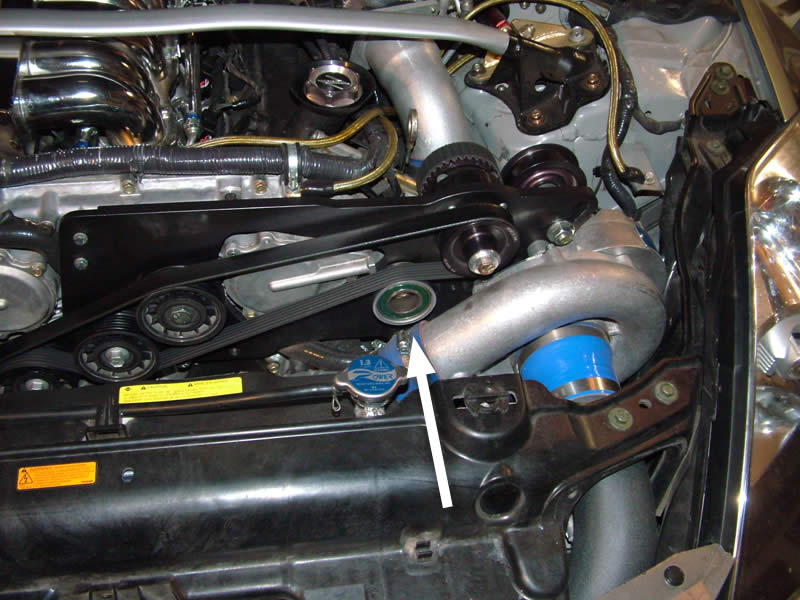

Jon at dynocomp is going to try something that we think will eliminate slipping and is fairly easy to do. If it works you might want to have him do the same thing for your car
there's also another way to eliminate slipping by totally reconfiguring how the belt wraps around the pulleys and removing one of the idler pulleys and changing one from a toothed pulley to a smooth pulley, but it's a bit more complicated to do

Are you talking about the addition of the two small pullies to heighten the tension on the belt?

yeah that's what I mean with the two pulleys

I had an additional idler pulley installed on the longest stretch of belt and no longer have belt slipping issues.
actually my belt is running at an overall slightly looser tension than it was before which on my car anyway, appeared to be too tight around all the pulleys while the tension on the two long stretches of belt going over to the supercharger pulley was too loose and thus slipping.
Now that one of those stretches is tensioned more and helps even out the tension so the overall tension can be loosened which stresses the bearings less and there's no slipping. Probably will help the belt last longer too
worked for me anyway

Sentry, did you have to drill the mounting plate to add the additional pulley?
