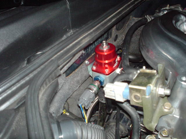

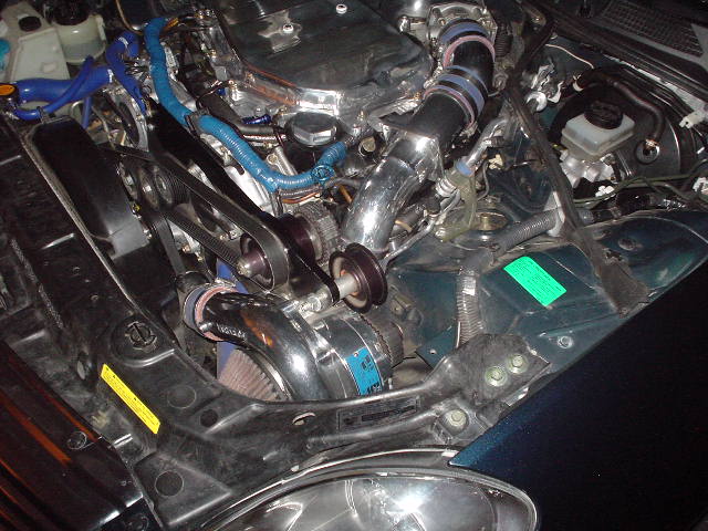

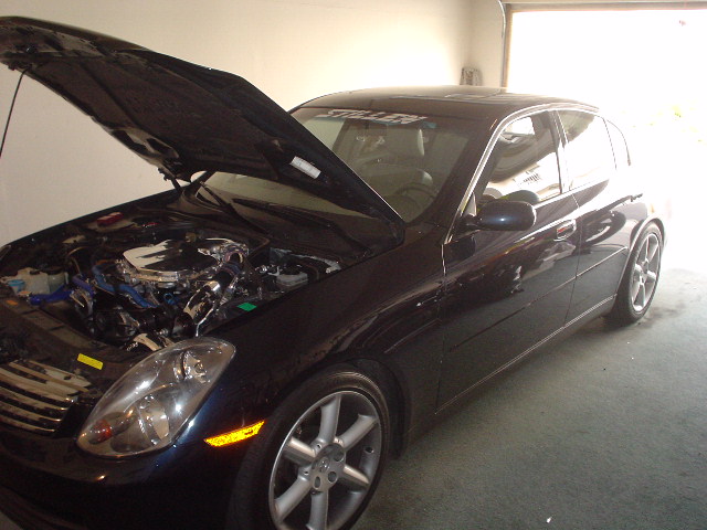

I finally got my car back from GT motorsports after a whole month.
I added many things toward my full rebuilt engine in December.

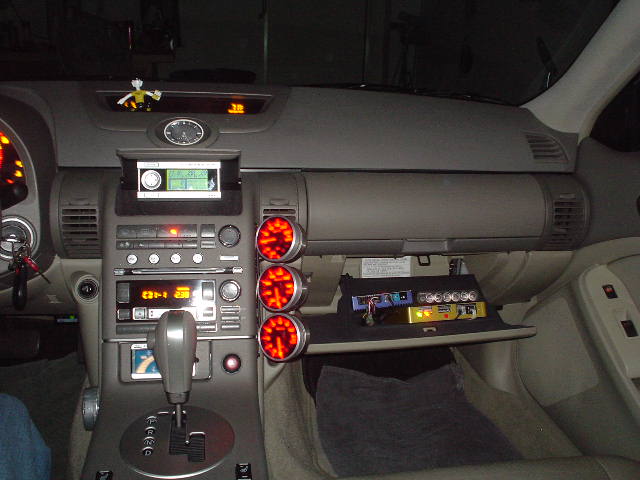

HKS full standalone engine mang.
HKS fuel/air read out.

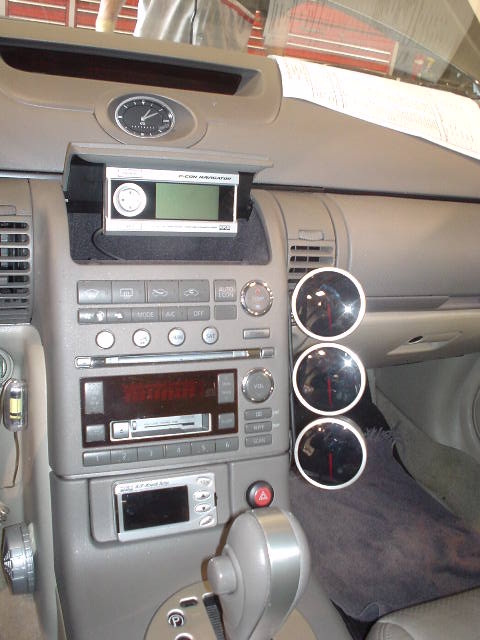

HKS Navigator.
3 defi guages.
Methyl injection... cool intake temp by 70F,
AAM fuel rails and full metal braided lines.
Walboro Gas pump.
New Valve covers
New 06 350z intake ports.
Aeromotive A1000 regulator.
Greddy spark plugs
Race pipes.
I have to say GT motorsports did one of the best installs on my car, and the car runs very smooth and fast. When I rebuild my motor this is where I will take my car, in December.

Sweet set up! Question...what do you think of the Navigator? I am thinking of selling mine actually and going with just regular gauges. When I had mine istalled they were unable to set the different maps so basically for me it's just a gauge that reads only metric and incorrect boost as well. Did they actually tune yours with the Navigatior?
Reply 0
Mar 16, 2006 | 11:59 AM
I like that gauge pod. Is it custom? If not where did you get it from?
Reply 0
Mar 16, 2006 | 03:20 PM
Quote: I like that gauge pod. Is it custom? If not where did you get it from?
The gauges themselves are from Defi... And they are directly mounted on the center console. Install very clean from GT Motorsports.. Southern Cali..
Reply 0
Mar 16, 2006 | 03:22 PM
Quote: Sweet set up! Question...what do you think of the Navigator? I am thinking of selling mine actually and going with just regular gauges. When I had mine istalled they were unable to set the different maps so basically for me it's just a gauge that reads only metric and incorrect boost as well. Did they actually tune yours with the Navigatior?
My navigator displays a lot of info about the motor.. Oil temp, pressure. Injector Info, timing, A/F ratio, RPM, speed, and whole bunch of stuff I dont understand yet.. Right now it seems a bit overkill but once I have a built motor soon I will need that valuable info on my car.
Reply 0
Mar 16, 2006 | 03:42 PM
Yeah, same here, when I bought it I was under the impression that you could actually set 3-4 different fuel and timing maps. I was just curious to see if your installer knew anything more about it than mine, Did you get any english instructions with yours? If not let me know I have a link somewhere that translates all of it to a PDF in english. Again man great looking set-up hell of a sleeper!
